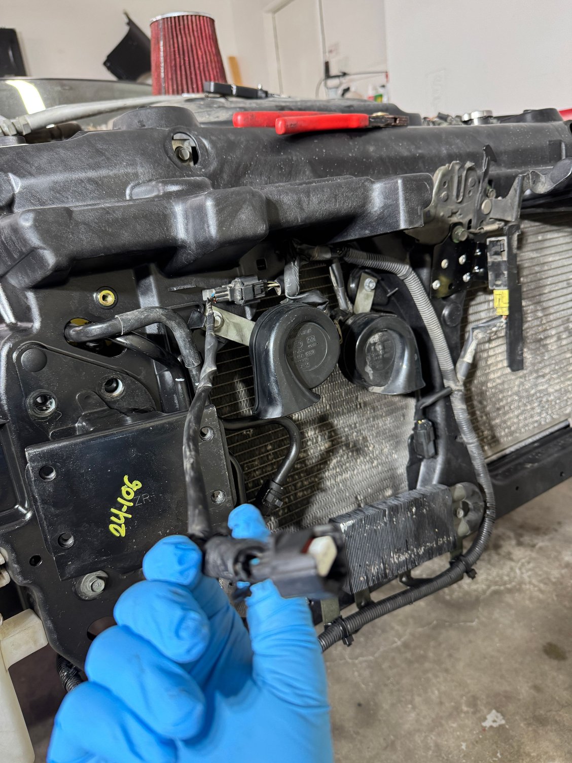

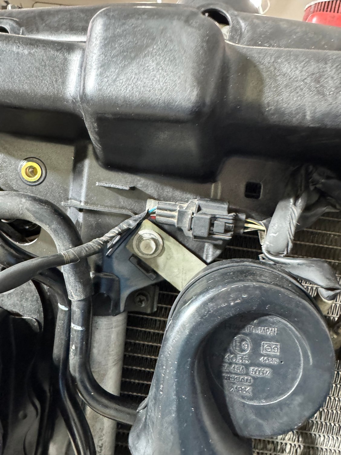

Hey Guys, I'm putting the core support back on my 350z and can't seem to remember what this plug goes to? Here's a pic of the plug and where it connects to another plug behind the horn. Please help!

A/C pressure switch on the condenser. Its really fun to get back in. I usually have to take the radiator loose.

Thank you so much! Took 3 min to pull the radiator away and plug it in
