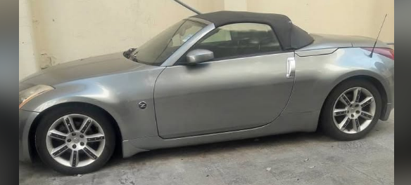

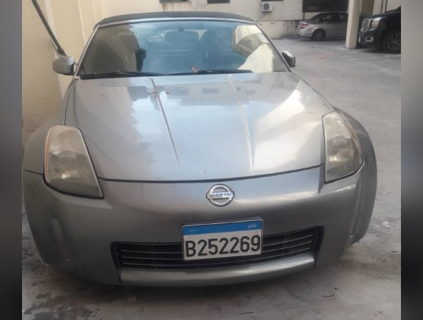

It looks like it's been dropped. The front is far too low to be stock suspension. I would take a peak at the springs
I'd only recommend getting some aftermarket OEM headlights to replace the foggy headlights(or wet sand and buff)
Make sure tires are correct size (those wheels look like the stock touring 18x8 wheels with stickers on them)
Front 225/45r18
Rear 245/45r18

the car has definitely been lowered. As mentioned above wet sand and buff the headlights. They'll bring them back to life

That's actually the normal ride height. This Z hasn't been lowered, you can tell by looking at the rear ride height. But I bet the front struts are shot, so it's sagging a little. This is pretty normal to see on these if they're still equipped with the original struts.
That's actually a really good price for a running/driving 350Z with everything working. I can't say I like the paintwork done to the spokes on the wheels, but otherwise this Z looks unmolested. Start with fluid services and a detailed inspection of rubber hoses, bushings, etc. Heel is right, I would replace the tires if they're 7 years old. Other items like coolant, brake fluid, clutch fluid should also be replaced.
