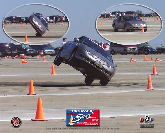

Having autocrossed for a number of years now, I can say that most any car can be flipped, given the right circumstances. I have seen several cars on two wheels (_way_ up on two wheels). I know of an ///M3 lightweight that went over (slid sideways, hooked the rims on the grass at the edge of the pavement, no curb).
It is usually due to the dynamics of the transitions, rather than sliding sideways. Occasionally there are right - left - right transitions that happen to find a sweet spot in a car's suspension and cause the body roll to actually increase with each direction change. There is a certain slalom spacing (can't remember the exact distance between cones) that, if the driver doesn't give it up, a Del Sol with a stock suspension will go over eventually. It’s just a quirk of the chassis.
Granted, the higher CG cars are more prone (VW rabbit, etc.) The attached picture was taken at the 2000 Solo II National Championships by a professional photographer. I don't think anyone would argue that a Saturn Coupe has a high center of gravity, and Koni Shocks don't exactly make it floppy in the turns...
BTW, the car did not go all the way over, Kudos to a great job of driving to bring this one back to earth in one piece.

Hypothetically, say you're driving like mad and the car goes up on two wheels like that Saturn. Then what are you supposed to do? (I'm no stunt driver, but knowing is half the battle.)
I just thought I'd better ask, or else I'm going to be on two wheels some day and think "darn I wish I had asked."

Steer toward the ground (in the case of the Saturn, that's left) until you fell the car start to rotate back down, then steer straight and prepare for landing.
