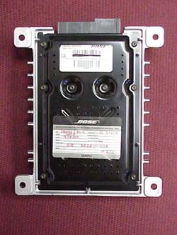

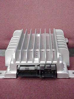

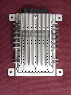

I picked up my Z (PPW/Touring) the end of 8/02 and love the car except for the stereo. My dealer has been in touch with Nissan in Jax, Fl and on 10/11/02 the dealership received (Fedex from Bose) a new amplifier to place in the car. I was assured this is not simply a "replacement" amp, but rather a fix which Bose has been working on for weeks in response to the numerous complaints about the ruddy, muffled sound, especially on the radio (as opposed to CD play).
The improvement is amazing. I actually enjoy listening to the radio now. The vocals in songs are easily heard with good sound separation. The bass is noticeable, but has a pleasing not overbearing sound, even at factory preset levels, ie, bass, treble, fader, and balance at zero. (I previously has to do some weird adjustments just to listen to the radio--- bass -3, treble +2, fader -2,etc...).
Also, the amp is located in the left rear of the car next to the spare, so the dash/radio did not have to be invaded and make squeaks more likely. The new amp took less than 30 minutes to replace.
The new one looks just like the old one, but has obviously been tweaked. I have attached pictures of the new amp from Bose.

Sag can we get a higher resolution pic of picture no. 2 (the labels in particular). I wonder if the label would clue us (those who are about to get our cars) in on if we got the bum amp or the fixed amp.

Z Girl...sorry for the late reply.
I had been in contact with the manager at the Nissan dealership and he knew a solution was "in the works".
His contact at Nissan in Jax, FL called last week and said a shipment was on the way Fed-Ex from Bose.
The manager actually thought they were shipping a radio, but called me and said it is an amp and I took my digital camera when I left the Z.
As far as arranging the fix, Nissan has not published a TSB as of yet, so many dealers may be clueless about the amp replacement.
I hope this helps,
Scott
