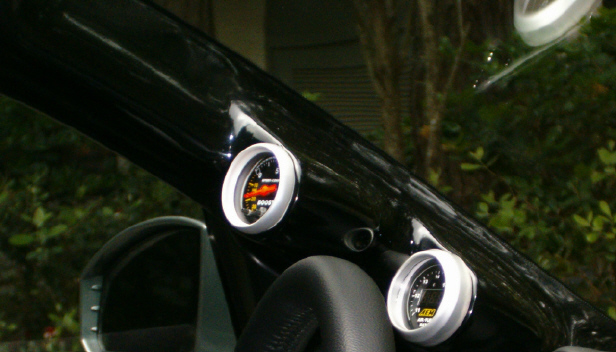

I believe the OEM gauge pod cluster in the dash holds 52mm gauges. When opened, you will find that all three of these displays are connected to one circuit board...so you would have to put three new gauges back in AND loose the mulit-data display altogether.
The nav compartment is a good option for 60mm gauges.
You could have a custom fiberglass fabrication for a couple of pods in the sunglass holder area.
Custom fabrication on the A-pillar. Or the autometer A-pillar works well for much less money.
Two 52mm will fit below the A/C controls...don't know about 60mm...would be tight but maybe.
hth
Attached Thumbnails Quick I Need Advice On Where To Put My Gauges-apillar2.jpg
