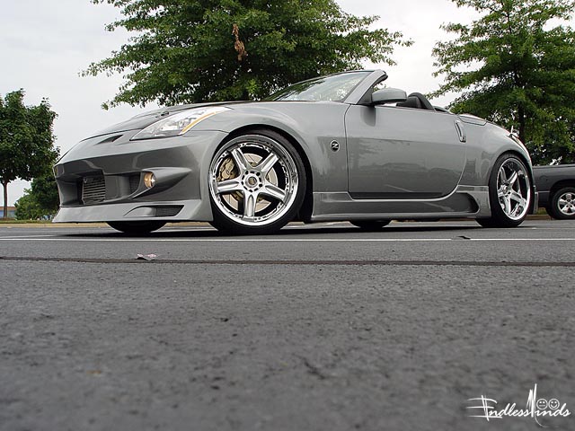

Nice choice on the wheels, I purchased mine from Jeff at Evolution Autosports and was very pleased with the service and price. Mine are 19x9.5f and 19x10.5r with a 245/35f and a 285/35r tire, even with the car lowered I have no clearance issues. A set of wheels will deffinitly make the car look much more agressive.

threefifty your z looks hawt.

ThreeFifty that is one hot car. i like it alot. The kit and the wheels look great together!!! But yes, i will be doing the wheels first then. I have made up my mind. Thanks for all the input. When I get the wheels i will probably buy springs for it also, possibly even do sway bars. If i'm lowering the car tho, do i need to buy new shocks or will the stock ones work fine?

Eibach makes a camber kit, but I've never seen it installed. My wheels do sit like this /---\ in the rear with just eibach springs. If you plan to lower your car and drive the car daily, I think it would be a good investment to purchase a camber kit, or your new tires will show wear on the inside edge. Thanks for the positive response on my car, it makes all the work worth it. Check it out in Turbo Magazine this month.
