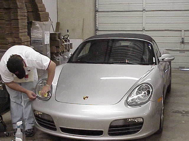

I know its not a Nissan, but here is a picture of an 05 Boxster with the film applied to the front. Porsche is aware of the problem and gets its cars patterned before they are released to the public. The new Boxster won't be available for a couple of months but Porsche knows that this is the best alternative available under the current environmental laws concerning automotive paint.

How is washing the car, once that film is applied? Is there moisture buildup?

There will be some moisture under the film just after the installation similar to window tint, but once it has had time to "cure" ( time will vary due to the temperature, but usually between 72 hours to a few weeks ) no moisture will get under the film. Just wash and wax it like its not there. You may get some dirt or a wax buildup along the edges but that can be easily removed with a detail brush, just like along a pin stripe.
More information is available here:
http://www.speedfilm.net/faqs.html
http://solutions.3m.com/wps/portal/_...2/_s.155/98916
