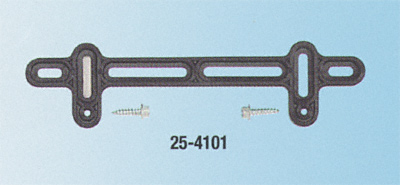

I got pulled over by a cop last month for no front license place. The cops in LA have been pretty aggressive lately. Although this is the first time for me for a fix it ticket I've gotten a few by the LA Parking Enforcement too. So I've decided to finally mount the front plate
After a recommendation on either this board or another 350z board I found this at Pep Boys on my way home tonight. It was only $3.99 plus tax!

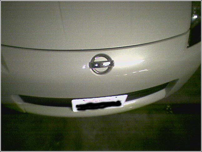

4 Zip Ties later and we have this. Sorry for the bad quality I used my crappy camera phone.

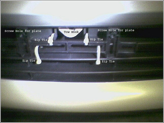

There's nothing holding down the plate from the bottom. I took a picture of the bracket with zip ties w/o the plate. As you can see there are 4 zip ties (2 on top, 2 on bottom) The bracket is basically balanced so that it doesn't angle/tilt too far down or up thus keeping the license plate straight and level.

The brand is "Superior" and it's part #254101 at PepBoys. I would paste the link to pepboys.com but it's really long. Search for "universal license" and it'll be the first item. $4.xx online.
