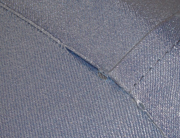

Well guys, I went to check my top, sure enough, I have the same issue. Need to go talk to the dealer. Here is a picture.

Talk about color fade....
Old Oct 8, 2005 | 10:02 AM
ohw's Avatar
ohw
Posts: 676
From: Canada/USA

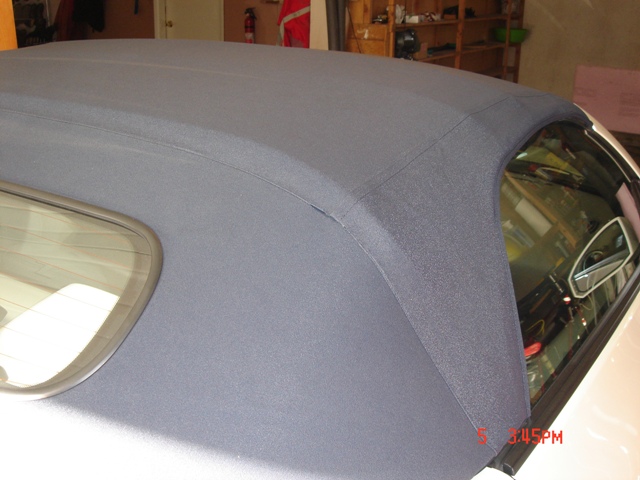

Actually, it's not color fade. It's a blue top. The picture was taken with a flash. Color-wise is still very new. The top is down most of the time and have not seen much sun at all.

That is exactly where mine is starting to come apart. I have one year left on the warranty, if something is going to happen, I hope it happends before then.

I must be overly sensitive, as I believe that the separation on my first top was less than half as long, and I got it replaced. The one now is about a fourth of yours, and yes, I'm talking to the dealer again. Catch it early, replace it ASAP.

Damn, I found a small tear too on my top about the same location as OHW. I had my car less than a year. Sucks if this is really a oem defect. $2k is too much money for dealers to charge for replacement if my warranty runs out.
