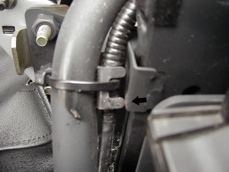

Attached is a pic of the location of the rattle / squeak I found on my 2007 Roadster.
There was no Service Bulletin covering this particular metal-on-metal rattle.
The rattle only occurred when the passenger window was fully up (and putting pressure on the top), and when hitting certain bumps or uneven pavement.
It was difficult to locate since the sound resonated throughout the tubular support arm, but you would hear it in the general area to the side of the top behind one seat or the other.
The rattle was fixed by bending the offending tab on the cable guide about 2mm so it would no longer touch the piece in front of it. (Two whacks with a flat punch and hammer.)
Open the top a little bit to get to this area.
Hope this helps someone.
It has been given to my dealer Hall Nissan for forwarding to Nissan in case they want to use it.

Thanks much for sharing. I've got an 06 roadster with an annoying metal-on-metal vibration coming from the passenger side, and I had hoped that your pic/solution would have solved the problem. Unfortunately it didn't.
On my Z, there's nearly a 1/4" gap there on both sides. I wonder if yours was an isolated incident.
Ditto for me.
