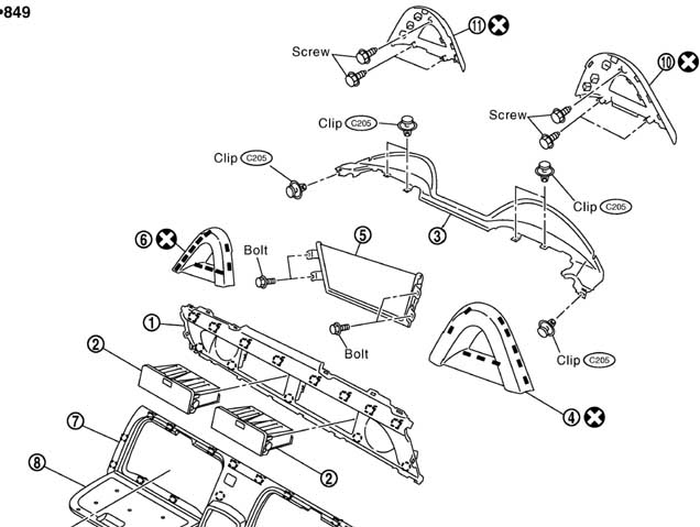

Here is a picture of the moronic part.
The X in a circle means "replace each time" in the manual.

If you look at the pic above, all four pieces have Xs by them.
4,6,10 and 11.
4,6,10 and 11.
D'Oh! You are clearly right.
I guess I should have looked AGAIN before posting.
However, as someone else noted, the tabs are on the front piece and they are what break off. I bet the back piece is much easier to re-use since it doesn't have tabs, just sockets.
