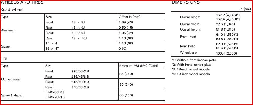

The manual is available at the other 370z site.

43 front and then 15 rear?? whats up wth that??

Pretty damn high offsets in the front.

How would +22's look all around?

When comparing the sports package wheels to the regular wheels with stock tire sizes,
the fronts of the sports package will extend an extra 9mm, but the rears will go in by 2mm.
Do you have 9.5/10.5?
With a +22 offset, the fronts would not work, but the rears maybe.
With those specs, it'd be like running a 30-40mm spacer in the front.
Crap. It's going to be so difficult selling the front's and buying separate wheels for the front....fawk
