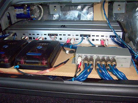

Not to difficult to make a platform from .5inch mdf. Use a couple of small spacer blocks on the bottom where needed to keep it level. Couple of L brackets on the left side to hold it in place and one support brace in the back to put tension down. That's all I did for my first install and it worked well.
Now that my amps are between the Hump and rear brace, I use the platform for all my crossovers.
Have a look.......
