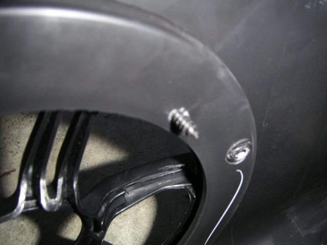

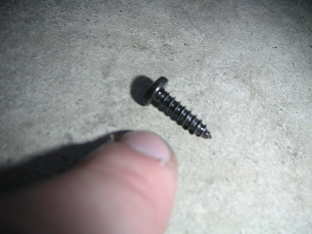

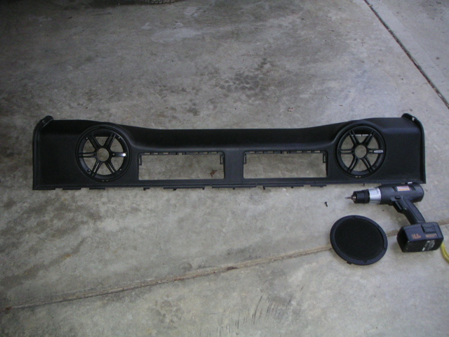

here are the pix. you will need four of those little screws percover to mount the covers and to pop the old ones out it was pritty easy but you gotta bust two plastic rivits to do it. they came out easy tho.

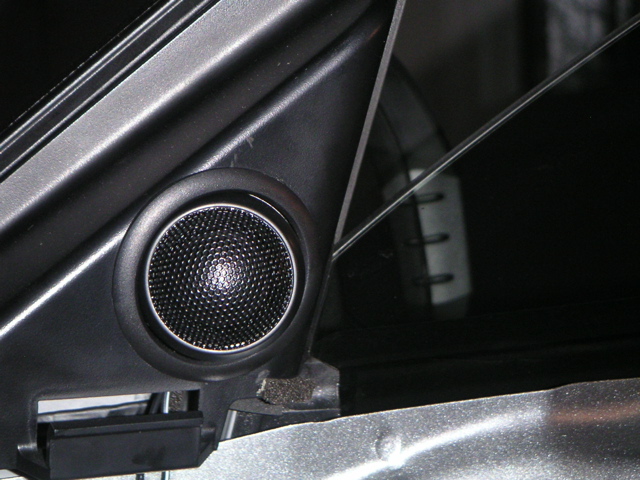

the tweeters were a bit big but i still wanted to use the aiming mount so i cut it exstra big i think the door panel will still fit

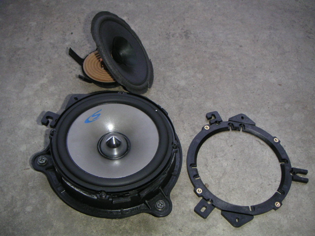

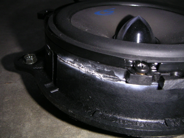

here is a quick exspanatioon of how i did the woofer mounts
you take the old plastic thing that the factory speaker uses and you break it out cutting the stuff in side to make you new speacker fit... then you take the braket that came with the speaker and cut off the stuff around the edges then you simply super glue it to the old speaker frame and you 'v got your mount
i hope this helps you guys out i didnt think to show how to do it at the time i did it. so the steps arnt that clear, but i think every one will get it.

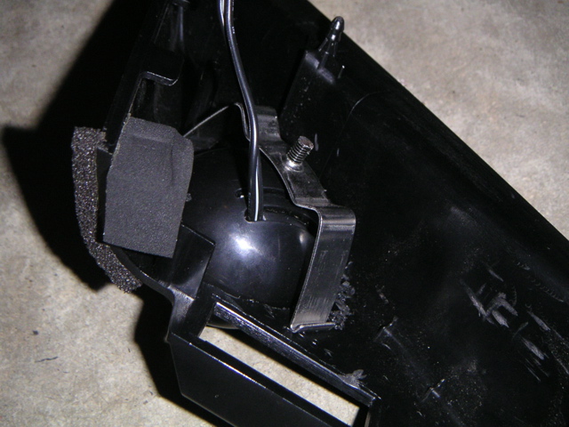

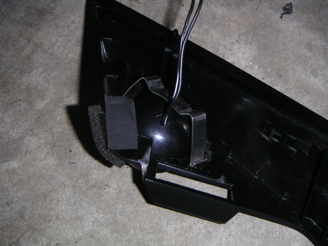

Have you put the door panels back on? I wanted to do that with my tweeters but didnt want to hack up that piece...How did you cut the holes for the tweeters? How is it staying in place...My Infinity tweets are behind the factory grill for now...

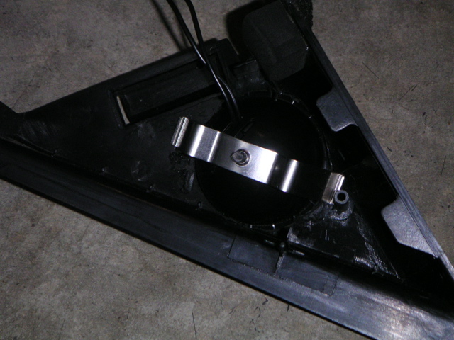

i used a dremal power tool to cut out the hole for the tweeters. the hole is about as big as a hole can be on the flat part. it is held in by a metal plat that is conected to a screw coming out of the end of the tweeter. i had to cut out some plastic colums or somthing to get the metal plate to fit.
this hole thing looks like i tore up the piece of plastic if i didnt cover up the hole with the tweeters case's lip thing. id never done anthing like this to a car before and was not sure if i would be able to do it. but i figured that the piece would be relitivly cheap to replace if i messed it up. i just trace around the tweeter case and cut out a hole inside it, then every once in a while i would put the cup in there and see how it was fitting, then dremal away at it.
i clicked at it with my camera to show some of the stuff i was talking about.
