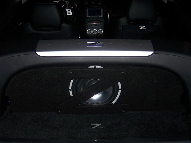

Big-Al (on this forum) has a 15" sub mounted there. He also owns/run's a local audio store here (AudiMobile) and did all of my work. Send him a PM for pic's. His setup is awesome! I went with a single 10" under the strut bar & its plenty of bass for me.

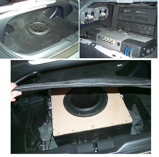

Default 12" MB Quart in spare tire well
12" in the tire location works well if you fiberglass. Actually, diameter isn't the problem, depth is. With about 7/16" thick f/g and 3/4" MDF top you will have only about 6" of depth for your driver. I ended up using an additional 3/4" MDF ring to act as a riser. Z carpet will cover the ring and a nice grill (like Audiobahn) makes a nice finishing touch. https://my350z.com/forum/newreply.ph...e=1&p=1491027#

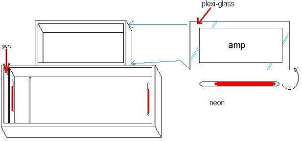

The paint picture is kind of crude but it's basically how my old setup was made.
Attached Thumbnails sub in spare tire compartment-speakerbox.jpg   sub in spare tire compartment-subcfiber.jpg
