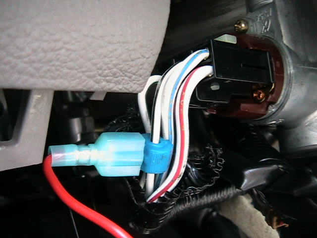

Good news is that I have a V1 on it's way, should be here by early next week with Mike's mount to boot. I did a search on something I heard that is used for a hardwire and it's called a fusetap. I'v tried to read as much as I can about hardwiring in to the fusebox on drivers side, but I'm still a bit confused.
1- If I strip the end of a wire and attach cig lighter fuse, which side of fuse peg should I use? I heard that it DOES make a difference which side you use.
2- Is it safe to use the Direct Wire Power Adapter to an ignition wire like in the image below?
Seems kind of ez, but I'm a lot better on the mechanical side of things. That's why I asked if it's better to use the fusetap.
Cool, just installed my V1 along with Mike Peronek's mount. Tested the V1 and it works great, the arrows are what really separates this RD from all the others.
I used the Add A Circuit which really made the install much easier, make sure you buy the Mini version and not the ATO because it will not fit in the fuse slot on the Z. No soldering or splicing involved, just simple hand tools. All you need to do is crimp the red power wire into the blue end of the tap and yer done.

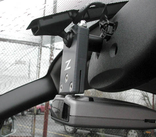

Here is the mount for the escort, but Mike also makes a mount for the V1 which basically looks the same. It works great and looks nice. No messing around with suctions cups. He accepts payment by PayPal and you can find him in here by searching Mike3348 or mikes mount.

cool. is the 'z' a sticker i can remove? i have a g35.
No problem making the mounts without the "Z" sticker. I have sold a number of mounts for the G35's. PM me for details.
