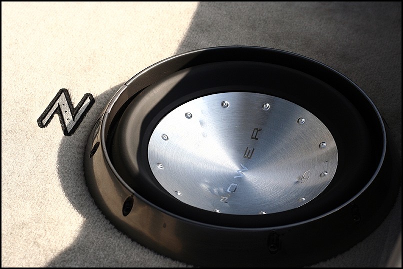

Originally Posted by SkiTTlez
i used the spare tire well....
So did I.

Old Nov 8, 2005 | 02:16 PM
bigk's Avatar
bigk
Posts: 40
From: Chi-Town Burbs
I like the looks of those. Is it easy to run the wires to the glove box thru the hatch? I haven't snooped around in a while.
How did you guys put those down, what did you use as a box? Any other pics, maybe as it was being installed?

Nice box contruction. My enclosure looks pretty much the same, except I used the trunk floor as the box bottom. I attached the inside of the box to the floor using L-brackets. then sealed the gaps with liquid nails. I figured this would keep anyone from stealing it. Using the floor as the bottom also eliminated the need for a spacer ring.
Very easy to run wires. just drill holes into the frame and put rubber grommets in the holes. You now have passage way from point A to B.

Originally Posted by vo7848
So did I.
did you get the T1 or T2? i got the T1! also with your use of L brackets to secure your box to the floor, where did you drill i the floor? i was thinking of adding a couple of these to the rear of my box. right now i have brackets toward the front of the box attached to the "step" in the trunk floorboard.
I quoted wrong, about the RMS of my sub, in another thread somewhere. Oh well. To answere your question. It is a T112d4. I'm running it at 2ohms. I am pushing the max amount of RMS power it can handle. SOunds great too. The "L" brackets are on the inside of the box. I did this so that a thief wouldn't be able to remove them without taking the sub out. My sub is fastened down to the box with allen head bolts that have anchor nuts on the other side. Removing it takes a very long time unless you have a power drill and the right allen tipped socket.
