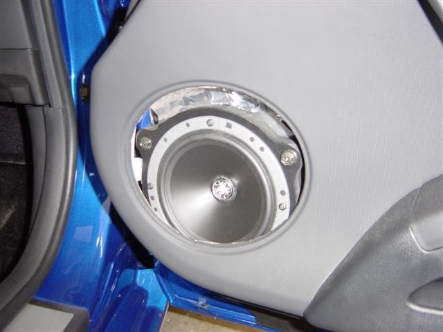

If you look take the grill out and put your door back on then you will see the speaker sits in their funny (compared to the contour of the door). Make sure you put the grill back on correctly, or the perforations will not be in the original space. Let me find a pic.
Old Jan 11, 2003 | 10:36 AM
VandyZ's Avatar
VandyZ
Posts: 3,702
From: Nashville, TN
From SKiDaZZLe :
Attached Thumbnails question about front speakers....-audio-install-010-small-.jpg
