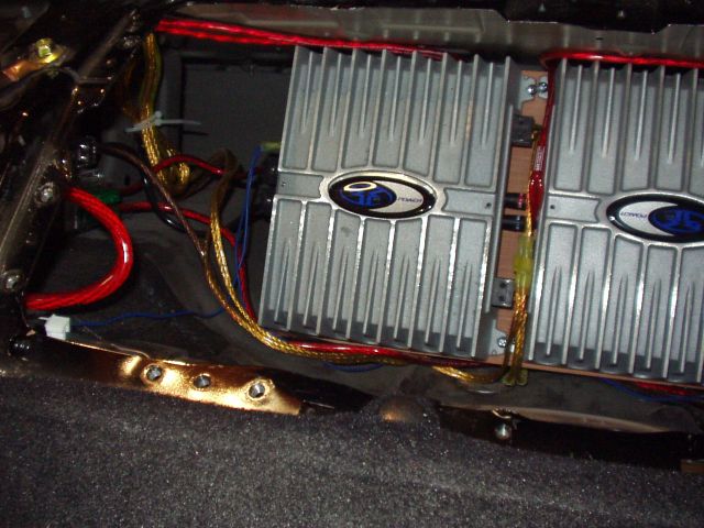

First, I wanted to hide away my amplifiers. I choose a Rockford 300.2 for the fronts and a 300.1 for the sub. These small footprint amps seem to fit well in my install plan, power range and price point as I picked them both up for around $100 each.
I screwed in a ¾ inch MDF backboard deep inside the compartment behind the driver’s seat. I was able to mount both amps to it without problem. Note that I also installed my distribution blocks to the inside of the enclosed area out of the way.
The depth is adequate to mount my sub and enclosure with the proper air space and allow some air to flow around the amps for cooling.

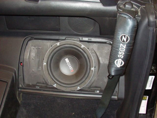

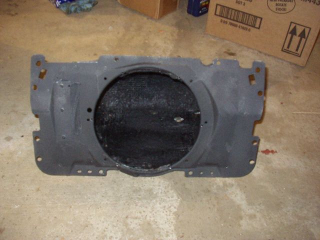

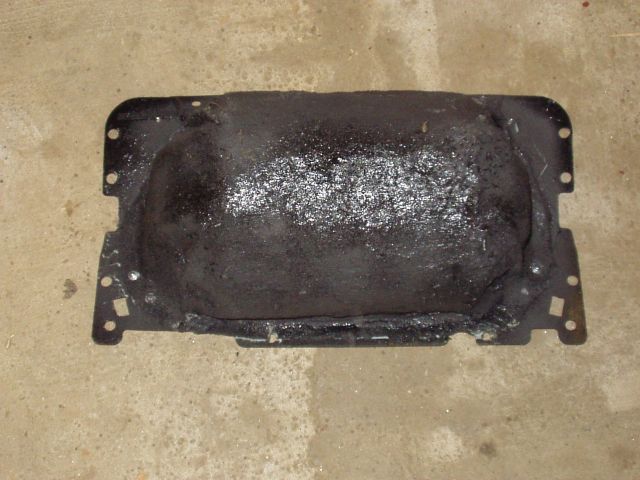

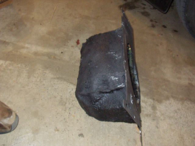

Second, I needed a sealed enclosure for my MB Quart Reference 10. I had this sub in my world champ car in 2002 and really enjoyed its characteristics, so I decided to put this in without hesitation. The sub calls for a meager .75 cubic feet of airspace, so I went about crafting an enclosure for the sub. The initial trial with MDF was a disaster, so I made a fiberglass shell over the factory sub mounting bracket in the Shape of a “Turd” for easy insertion and removal in the cavity provided.
The construction consisted of screwing down thick wire mesh in the general shape I wanted to the back of the mounting bracket. I then installed the mass and bend the wire to the desired shape in place. I then covered the shape with thick fabric and sewed together the “turd”. I applied several coats of fiberglass resin and baked until hard. I then coated the inside and outside with a layer of Tiger hair. Finally I pained the entire surface inside and out for appearance (it looked like a Giant Mary Jane Bud with green Tiger Hair on it) and to seal the fiberglass smell. I then mounted it in the cavity.
(Introducing the “Turd 2000” subwoofer enclosure)

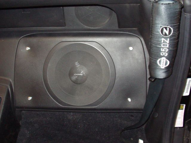

Finally, the provided subwoofer cover panel always rattled loose. I installed four removable screws with inset washers to secure the entire area down. I plan to paint these black to match.

nice system, except i'm not too sure of the 4 bolts, seems out of place...but i guess if it keeps it from rattling

Thanks, I thought the bolts looked at bit out of place in the pictures, but in person they are not so bad since I have the Inset washers on them. With the seat back they are hidden ofcourse, so I dont think much of it. Screwing that pannel down was a major rattle stopper. I added a couple of peices of 2" tick foam on the sides of the subwoofer to firm things up a bit too. It really helps and might be a good Ide for those that use the stock space.

Thank you, You should have seen my first attempts with MDF.. It was a disaster. I wound up with about .4 cubic feet of space.. I think a Single 8 Could work with an MDF enclosure, but a 10 definatly wont. I used thick fabric (Automotive grade carpet acutally) for the base layer that got the glass. it soaked up two whole cans of Resin! Between that and the tiger hair it is probably 1/4 in thickness all the way arround and hard as a rock. Took 2 Evenings to make, so it wasn't that bad.
