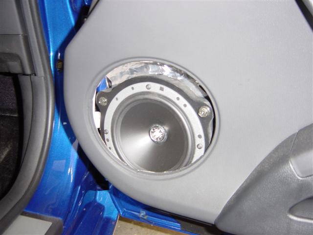

So the MDF that was used for the door speakers fix the issue of not being completely in the opening for the door panel?
I would love to get my hands on a set of those...
Mike
Yes, the MDF door enclosure did correct the alignment problem of the door panel not being centered. Here's a picture showing the alignment problem. In addition the panel also "bends" in toward the bottom of the speaker, so while the bottom of the speaker is flush with the door panel, the top of the speaker ends up being away from the door by ~1-2". By the way I am not criticizing this install job at all - it just illustrates what a horrible job Nissan did in lining up the speaker with the door panel.
So the enclosure they made, not only centered the speaker, but also changed the angle of the speaker in relation to the door panel. They did have to do a little metal cutting in order to accomodate the new location. This picture shows a silver ring they had made to match the other silver on the door, but the jury is still out as to what the final look will be. The picture doesn't really do it justice as the flash reflected off the ring and the angle of the picture makes it appear that it's not centered (due to the bump out of the door panel), but the ring looks completely stock and is definitely centered around the speaker.
Another thing to consider when using "spacers" to bring the speaker away from the door window is that they do cover up more of the back "basket" of the speaker than it was designed for (which is flush mounted). After seeing all of the problems properly mounting speakers in the door, I now understand Nizl's Solution.

How's the midbass response out of this setup? Also is that using the door as the enclosure or is there a back on that MDF. One more question, does dynamat seal the door for good midbass response?
Unfortunately I still haven't heard the system yet, as I am waiting for the new Alpine processor (PXA-H700) to come in. The system is up and running (with the H510 processor) and I have been told the sound is excellent, and that is without any tuning of the crossovers, etc. As far as the enclosure goes, it is open to the back. The MDF "spacer" was only used to correctly "align" the speaker with the hole in the door panel. I have no doubt the Dynamat seals the door for optimum sound. Sorry I couldn't be more help.
