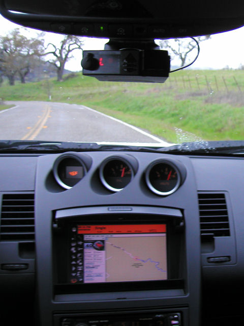

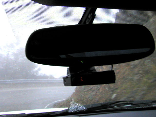

I have two pics of my setup but they are not that good, need some side shots.
To explain what is going on, I wired a phone wire into the rear view cable where it ran down to the mirror. This cable actually goes up the little plastic wire cover and then into the head liner where it turns around and plugs into a small phone cable female/female connector (that I found in one of those travel zip phone cord kits). The connector is 3M taped to the plastic wire cover and has a 4 inch phone cable coming out of it. I ran my detector with suction cups on glass for the first month with this setup until I realized I really wanted the rear view post mount from Mike. Now it hangs solidly below the mirror.
When the radar detector is not in the mount, the cable can be left on top of the mirror and it stays there even when driving. This is a rare occasion though because it's so quick to mount/unmount, I do it every time.
There is no need to do the extra connector for the install, it's just how I happened to install it because I wanted to leave room for experimenting with other mounting possibilities, like a g meter or something.
Chris
