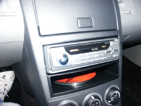

I have the Pioneer Premier DEH-p840Mp head unit too, and I used the metra kit as well. I did not do any grinding. Instead, I made a thin trim ring from abs plastic, about 1/8" thick, and mounted this between the head unit mount sleeve, and the metra kit opening. It took about 15 minutes to make this trim ring, it is not visible at tall, and my install required no grinding to complete. The face still operates fine, and the extra 1/8" give the new head unit plenty of room to do its thing. You cannot even tell that its not flush mounted. So, don't let the metra kit prevent you from getting a motorized head unit.
Attached Thumbnails Ease of replacing head unit on Nissans?-headunit_closeup_closed1.jpg
