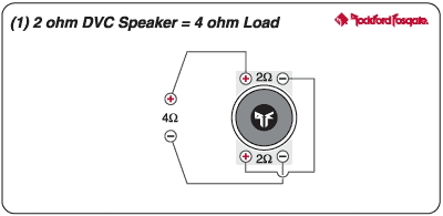

I got it...this one's easy.. If you only plan on running this sub, then you can wire your sub so the amp sees it as either a 1 ohm or 4 ohm load.
I also have a 2 ohm DVC(Dual Voice Coil) sub. Look at the diagrams I've attached it should help you configure your sub how you want it.

Since my sub is a dual 2 ohm voice coil and Directed D2205 amp i'm using says 600W x 1 @ 1 ohm, SUB on their website. do i need to use the parallel setup. here's the link for directed http://www.directed.com/audio/amps/default.asp#multi thanx again for all the help

that link doesnt seem to be working....but yes, you are correct. The parrallel configuration will trick you amp into seeing a 1ohm load, therefore delivering 600Watts on one channel.. Can that sub handle 600W RMS? If not, you can always turn the gain down on the amp...
