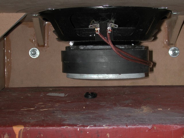

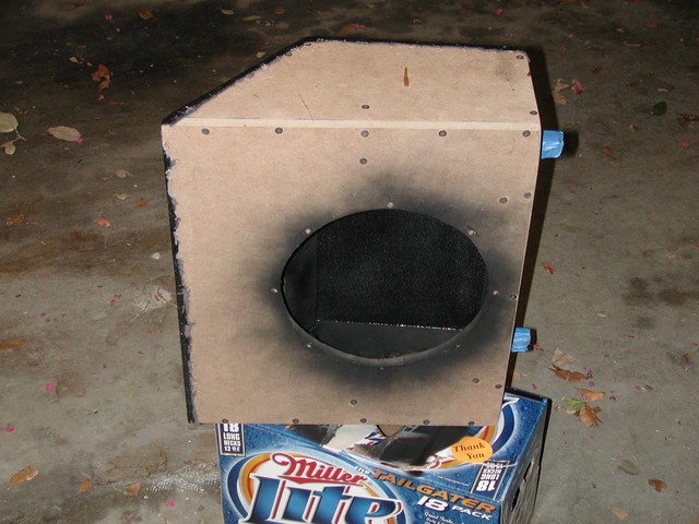

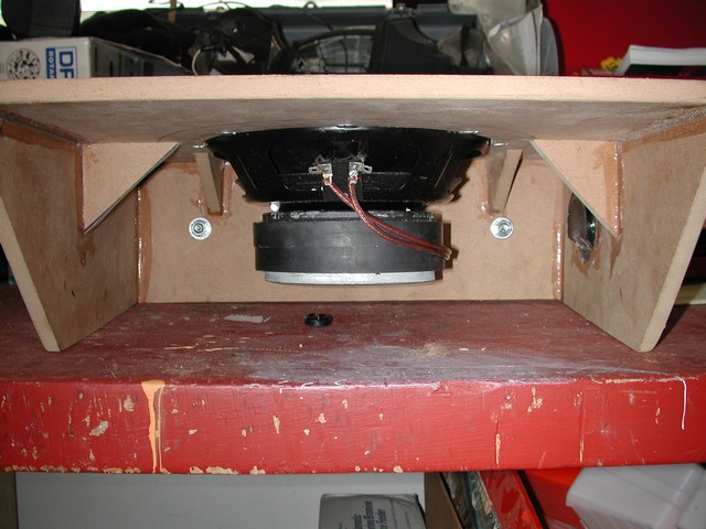

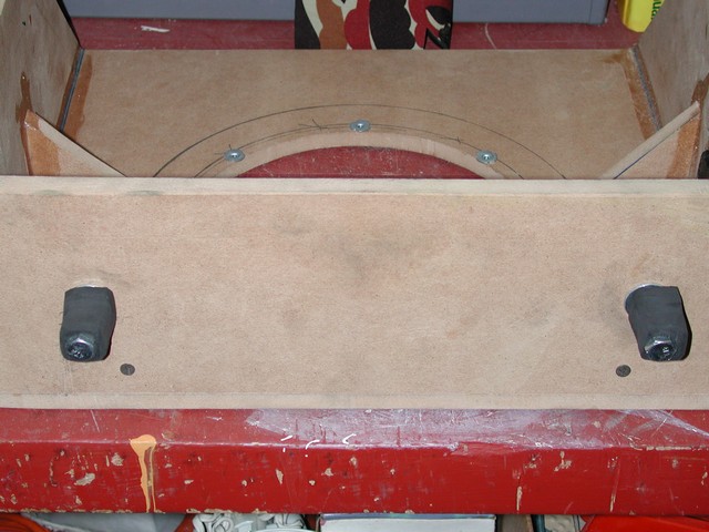

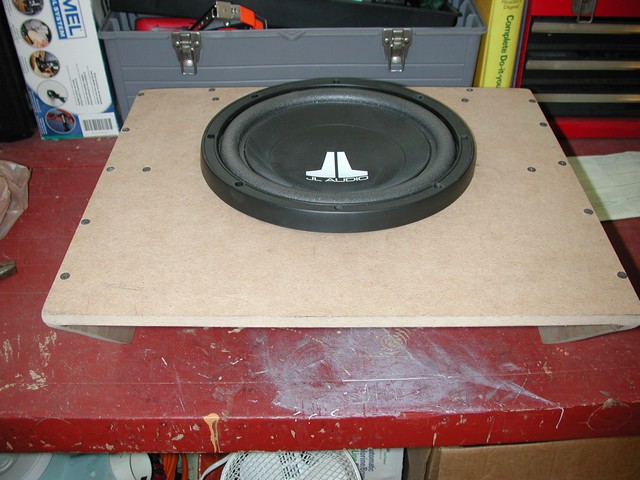

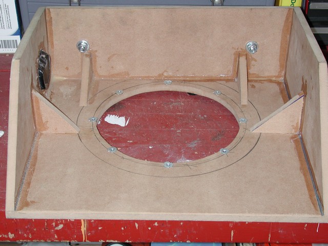

I decided to make a box too...It's half fiberglass/wood and replaces the glovebox or sub enclosure. I need some updated pics but it is in the car. I'm not real happy with the sound but it's better than Bose. I might go with a ID sub and scrap the JL. I think the JL doesn't have enough room.
Here a few early pics...Check out that beat up 10W6 the voice coils melted on that sucker.
I'll try to get some final pics in and out of the car.
Those odd shaped black mounts protruding from the side are mangled hockey pucks. It slides into the glovebox mount and I want rubber so it would make any noise. They look ugly but work great!

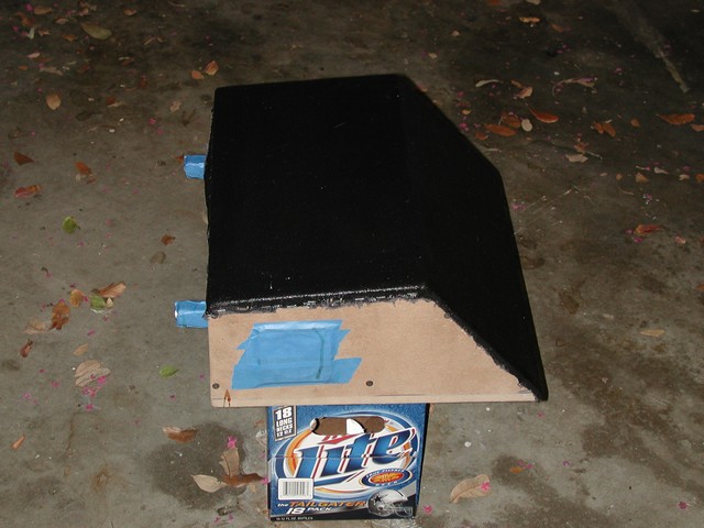

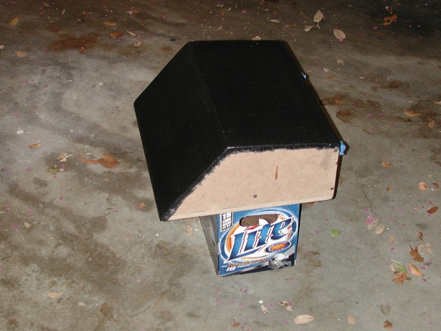

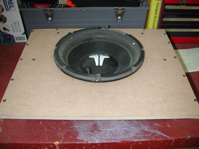

Few More....Box mounts firing down.
