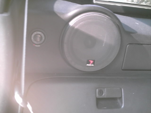

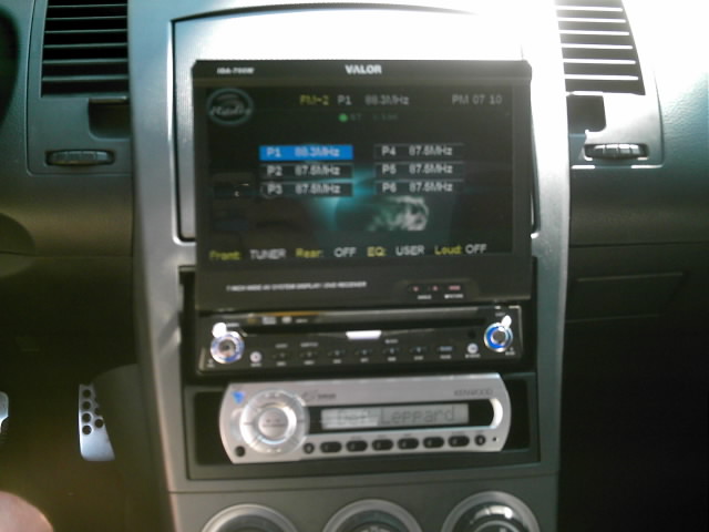

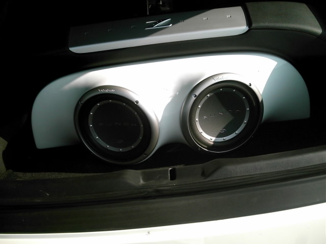

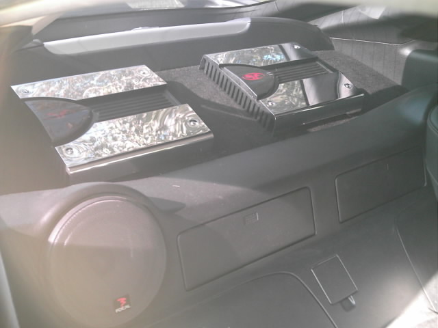

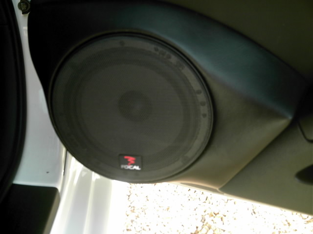

Use the 4 channel amp on the highs and mids and the 2 channel amp on the subs. FOCALS kick a$$ and you will be extremely happy with the money you spent on them; they are worth every penny. By the way here are mine.

What sub enclosure is that?......I have the Focals also

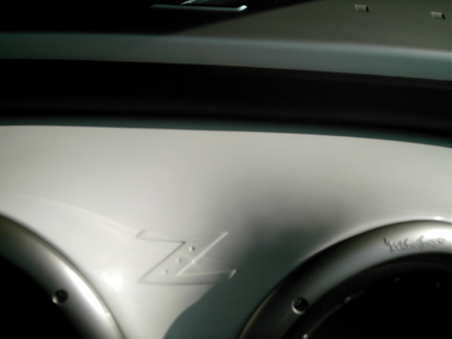

That is the TC Customs fiberglass box W/ 2 10's. It is painted to match the car. Quality stuff. Here is a closer look.

"Z"orilla: Where did you mount your front tweets? In the sail panel? Do you have a pic of how that looks? The sail panels are pretty tiny in this car and a lot of tweeters look out of place. I've been trying to decide where I want to install my tweeters when I finally do my install.

My tweets are in the sail panel. +1 on the FOCALS!
