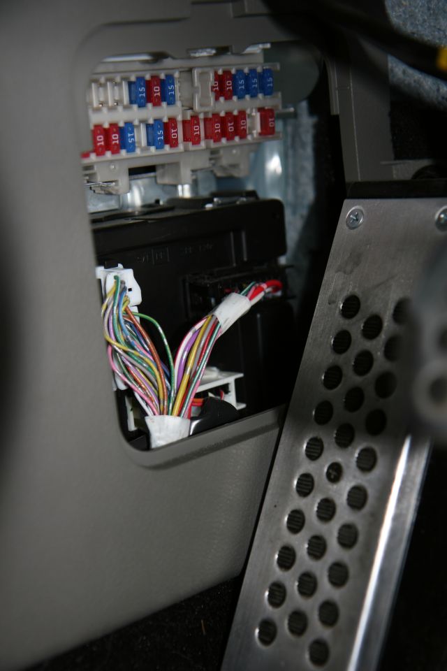

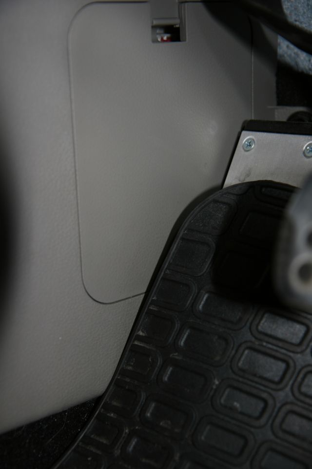

The body control module is located directly beneath the fuse block. This black box controls all of the functions you mentioned. I'd start by making sure the plugs are secure here.
Attached Thumbnails electrical problems or my car is possessed-bcm2.jpg   electrical problems or my car is possessed-bcm1.jpg
