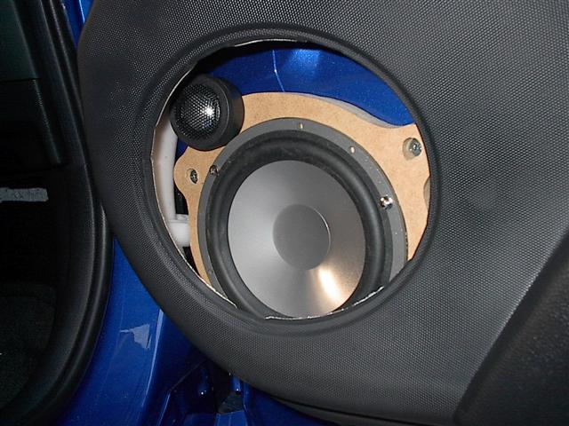

I got everything together and hooked up yesterday. I built a box under the tower, like others have. I built spacers with a spot to mount the tweeters. I think the stock location sounds crappy with aftermarket tweets, so I stuck mine in the door for better imaging. I also built an amp rack for my two amps, two crossovers, fuse block, and ground block. I still haven't found a good way to bolt the box down, but I will search or figure it out next weekend. Anyways here's the components:

About the tweet placement. Did you cut a hole in the door pannel for them? Could you post a pic with the door back together? I havent taken apart the door yet, but from looking at it, figured i would put my tweets next to the 6 1/2s. I just dont know how to do it yet.

If you look at the grill in the door it is off alignment with the speaker hole. There was enough room for the tweeter to play through. I'll get a pic tonight. The Hex tweeters sound like sh*t. I didn't like the way they sounded with the music I listened to on them. It's all personal preference, but my friend and the guy at the store thought the same. If I were you I would go listen to them before buying.

Anyways I started messing around with the cover that goes over the speaker after you asked for a pic. The actually cover is only open about 2/3 and the other holes are filled in, so I took a big needle and started poking them out where the tweeter is. Here is the pick of the cover after I poked out the holes:

I also took a pic with the door on so you could see how the alignment of the speaker from the factory is off. You can also see where my tweeter is and for some reason this is the first aluminum tweeter that I actually liked. I use to have a silk dome Boston Rally Component set and was always set on silk until I heard these:

Ah, i see how that sits now. That fits in there just right. Thanks for the pics.
