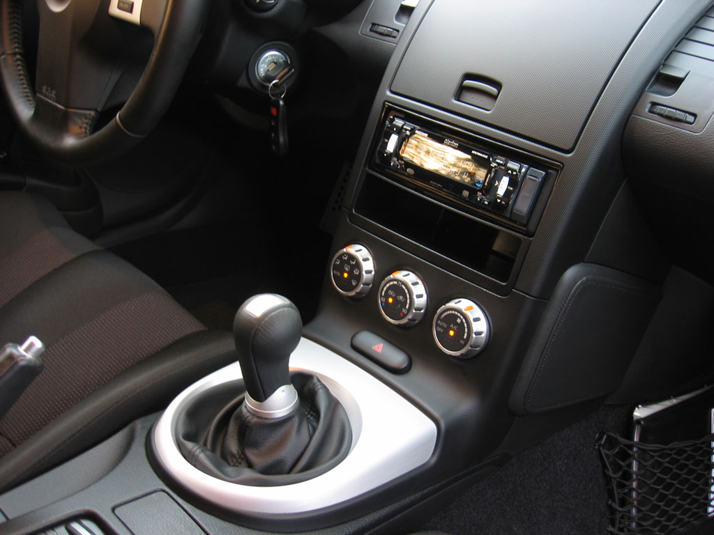

Well finally got my new headunit installed, which included a steering wheel controller, and Sirius installation. Couldn't find any good info on removing the panels, even Crutchfield doesn't have a 'master sheet' for it yet, just some useless notes. Here's a quick run through with pix to help anyone else who tackles this project on their new 07.

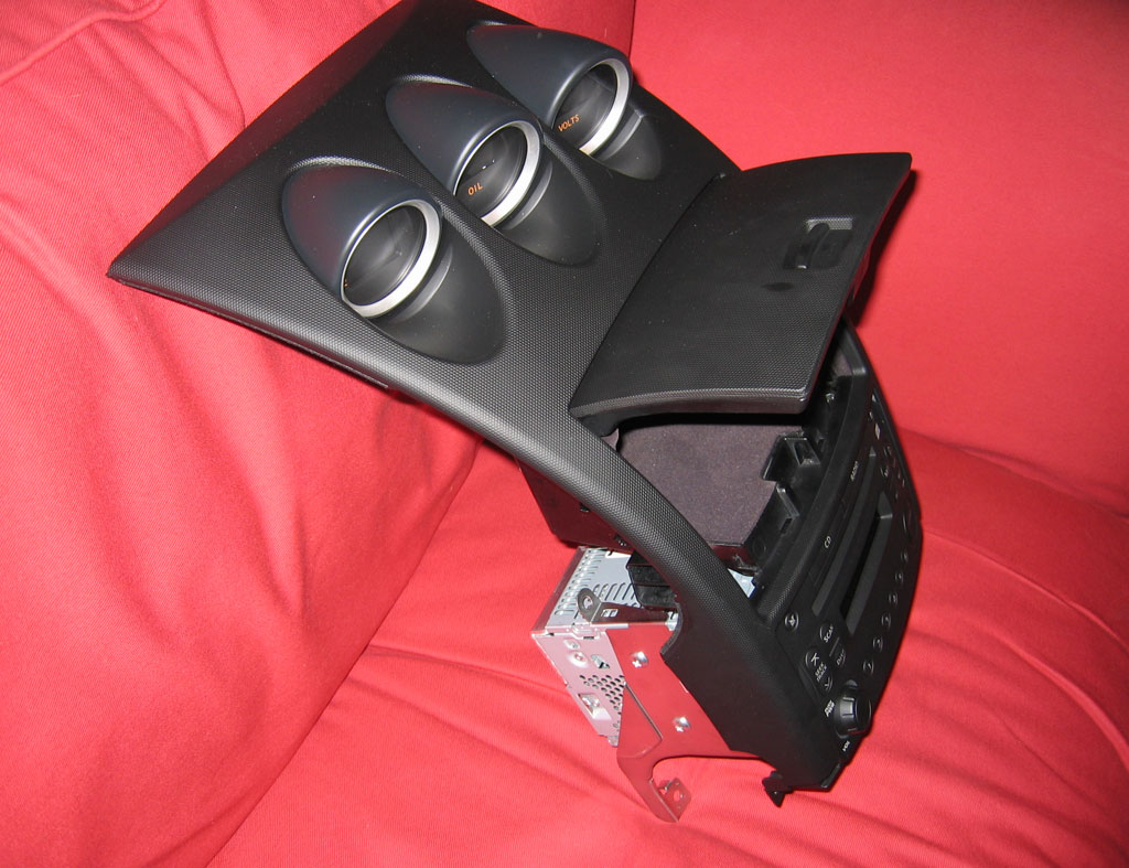

with all the screws removed you should be able to pop the center console out from the top by the guages, there is a clippy thing there that clicks it out. just pull on it from the top tilting it back, Disconnect the cable that connects to the guages.
Next remove the 3 connectors that connect to the actual stereo. The whole center console can be removed at this point.
I won't go into detail but there are a bunch of little screws that hold the doubledin stock unit to the console piece, just remove them and it will pop out.
Next I installed the single din with shelf piece into the console while out of the car, pryed up the tabs on the metal sleeves etc.

Installing the sirus was relatively easy, I velcroed the box under the passenger seat and ran the power and antennae cable up through the console, around the shifter and to the back of the cubby. I used doubled sided tape and mounted the antennae inside the dash as far to the front as possible. No roof mounted ugly install here. I get fine reception through the dash to the sky.
When I put the console back in, the srew holes didn't line up that are behind the cubby, but the other 4 held it just fine and is very solid and looks nice.
