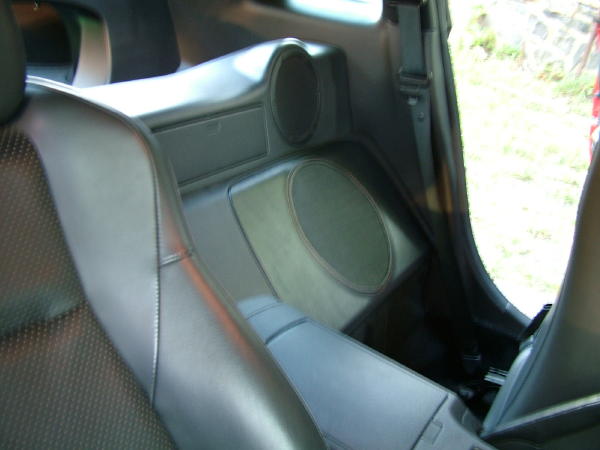

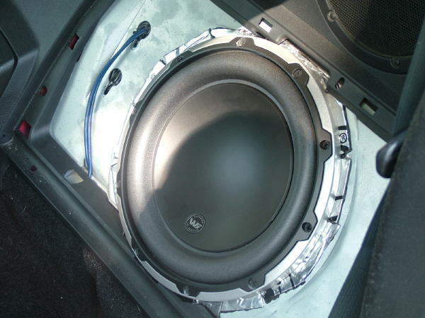

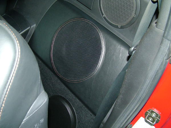

some pics of a jlw6v2 in the factory location
this set up sounds great, doesnt rattle , looks real clean and is stealth.
i recomend it to anyone shooting for those goals, if you are trying to win db competions this is not for you!

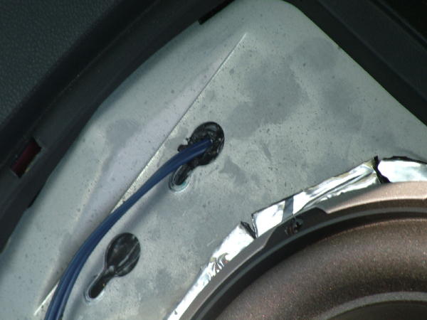

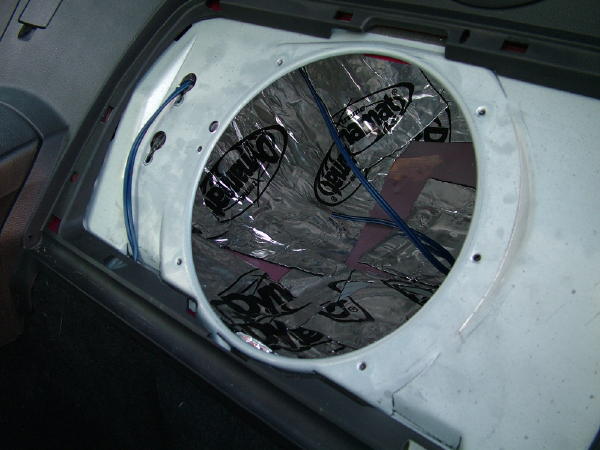

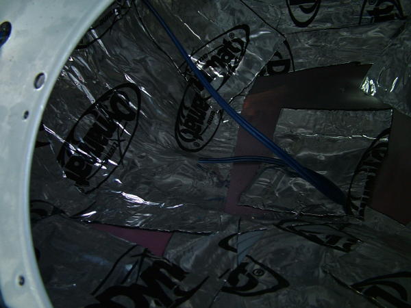

I just started to install my system with a MTX Thunder6000, got a few questions CHEFREY,
How did you covered the big gaps inside the enclosure since the Dynamat is not hard enough?
What about the the lip of the sub not matching with the factory holes in the plate? did made a dummy ring to attach the sub?
In my system, the plate rattles pretty strong, besides the dynamat, did you do something else?
Thanks for the pics, really helped... I'll post mine in a few days.

Originally Posted by sjk9671
Is this a 10 or 12?
it is a jl10w6v2 meaning that it is a 10 (sorry)
as far as seeling the area goes you just have to cover all the ares that have holes and joints and then go over them again creating false walls using whole sheets of dynomat with the dynomat from top to bottom and side to side including where the seat belt is, you have to sure to seel everything 100% air tight or it will not sound as good and that will also help quiet the rattling. as you can see from the photos there is hardly any metal showing in the cbby hole, i used a whole trunk kit during the process.
i di not use the factory mounting holes on the bracket i just adjusted the sub position till i could drill new holes and not use anyof the old ones.
make sure you line the ring were the sub screws to with dynomat even if it takes two layers to make sure the sub is seeled in place and stop the rattling
