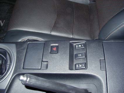

put it in the change drawer!

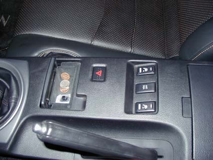

when closed it is out of sight!

Uh, I think thieves would be looking in the change bin for change.
