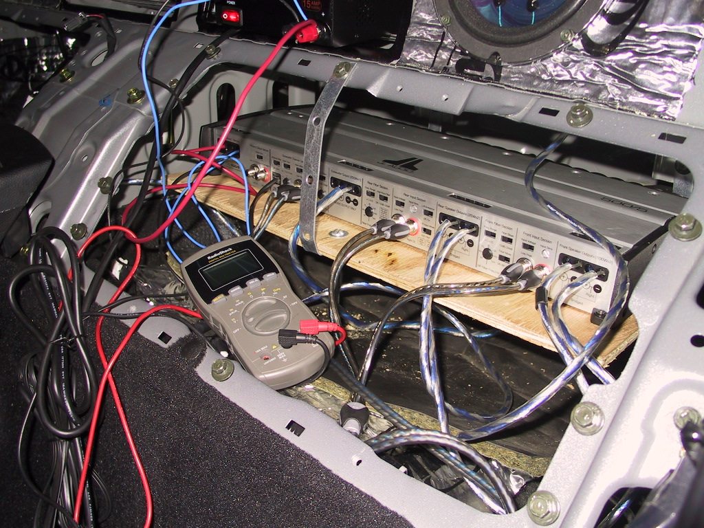

This is how I mounted my JL 500/5 in the subwoofer location:

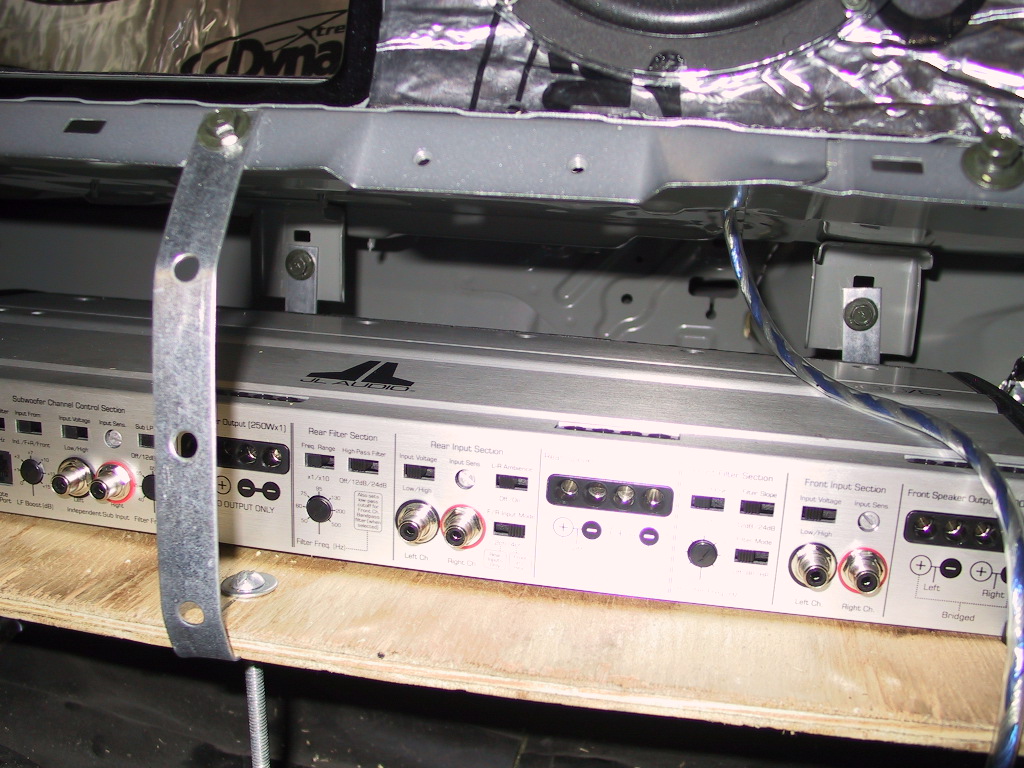

Bench testing:

Topgear, what speakers and sub are you driving with the 500/5 if you dont mind me asking? I was thinking about using this amp as well, how do you like it?

JL 10W6 Subwoofer
JL XR650-CSi Components - front
Some recycled Blaupunkts in the rear
The quality of the audio is way ahead that of the stock system.
