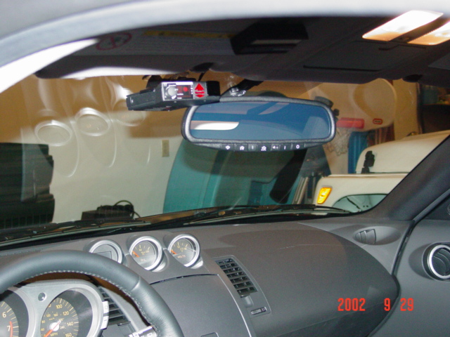

How's this?

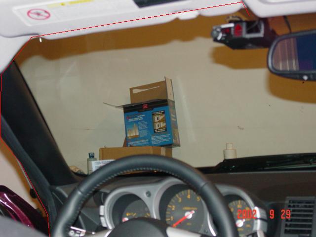

If you do a search on Valentine One Install you'll see a ton of threads showing you a lot more.
The red line shows the path of my wire to the fusebox.

Hey Bonz, You have HomeLink on your mirror, and a garage door "remote" on the visor!
Whats with that?
Is that a "Chamberlin" remote? Program the the remote to the homelink, and then push the "learn" button on the opener motor and the push the homelink button you programed 3 times for 3 seconds each time.

I was looking to install my V1 today in the same location but when I looked more closely I saw that you lose the ability to use the sunvisor when its located in there.
Back to the drawing board...
