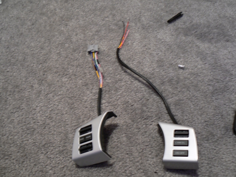

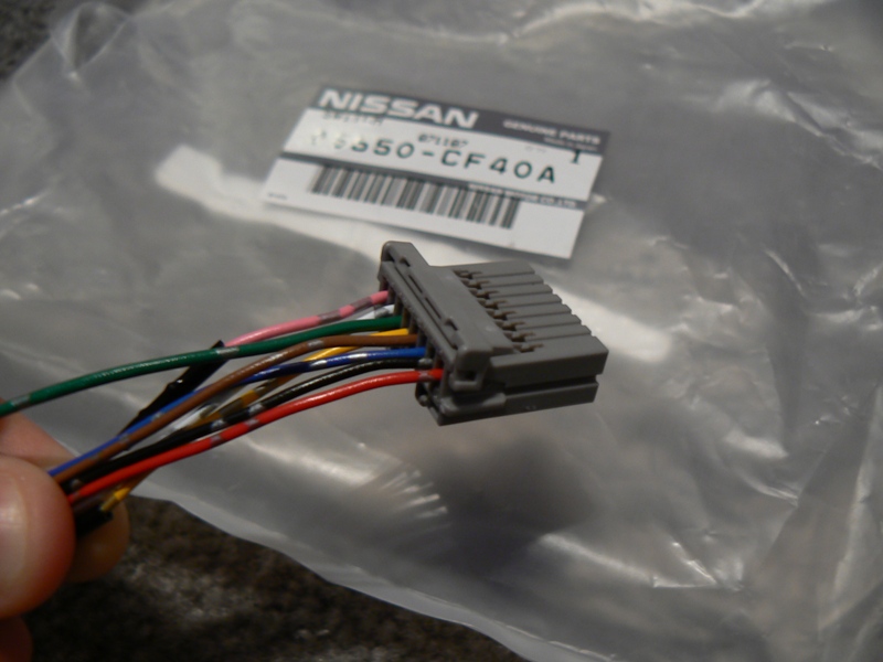

Since 2006, all z's have been prewired for the steering wheel audio controls. Nissan part 25550-CF40A ($59), contains the cruise and audio steering wheel controls for 06+ Z's. Both button assemblies are wired together, and I decided not to have the non-functional cruise controls installed. I removed the cruise portion from the harness and kept the blank piece on the right side of the wheel.
This all just plugs in. You can install the cruise controls if you want, but they wont work, just light up.
Here a few pictures from my installation.
Attached Thumbnails Add steering wheel audio controls on 06+ Base Models-p1030078.jpg   Add steering wheel audio controls on 06+ Base Models-p1030080.jpg   Add steering wheel audio controls on 06+ Base Models-p1030082.jpg   Add steering wheel audio controls on 06+ Base Models-p1030087.jpg   Add steering wheel audio controls on 06+ Base Models-p1030089.jpg

Originally Posted by JL350ZSD
Did you just pull the cruise wires out of the connector, or did you cut the wires?
I went ahead and removed two of the pins for the cruise. The cruise buttons use 4 wires, and two are shared with the radio buttons. I cut the shared ones and removed the pins for the other two..

Just a few tips:
You will need a few sizes of tamperproof torx bits. You will need to remove the airbag and wheel to access the screws that secure the button panels. To remove the airbag connectors, pop up the black clips on the orange and yellow connectors. Once the wheel is out, you will need to remove the screws on the back of the wheel behind the blank panels, as well as one screw on the front bottom inside that is under the airbag/horn bracket. To get at this one screw, remove the airbag bracket by unscrewing the two torx screws that are spring loaded for the horn. then you should be able to remove the black plastic trim from the back of the wheel, revealing one more screw for the blank panel. When you are routing the wiring for the audio controls, run the wires behind the airbag/horn bracket.
Hope it goes as smooth for you as it did for me...
