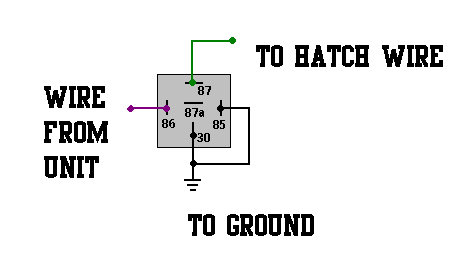

does anyone know how to make the switch on the headunit pop up the trunk. I think the duke did that. That would be really nifty. Also does everyone drill their brackets so that the headunit sits a littleback more. I didnt have a problem until everyone started talking about it. LOL.

P.M me and I will send you instructions how to wire up the hatch pop

I received alot of PM's about the hatch pop, so I will post a diagram here on the boards how to do it. Give me till tonight to draw it up.

Ok here is the diagram for wiring up the DDX812 or DNX8120 to pop the rear hatch from the headunit. First of all you need a basic Bosch type relay. You can purchase these at any auto parts store or you can even go to a stereo shop and they will sell you one. Should not be more than 5 bucks. You can either get the 5 prong or the four prong since you will only by using only four prongs. Prong 87a will not be used. The diagram should be easy enough to understand, but I will break it down anyways. The wire coming from the head unit(marked relay 1 or relay 2, does not matter which one) will connect to prong 86. Prong 85 and 30 goes hooked up to a solid ground. Prong 87 goes to the hatch wire. This wire is located in the BCM which is in the drivers kick. It is a pink wire on the harness and is labeled as pin 30. This vehicle information is for a 2005 which is the year I have. This may or may not be the same location for other years. I know for a fact the 2003 used another color, but it also was located in the BCM at the drivers kick. One more thing you must make sure the wire you are using from the headunit is set up for pulse, not latched or timed. Hope this helps most of you. On another note, this is not limited to poping the hatch. The head unit can trigger neon lights, roll windows up or down, activate motorized amp rack, turn on fog lights you can even use it to activate a garage door. Just understand how you wire up the relay is different for every application.
