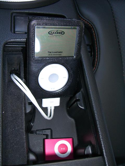

I got my Axxess from here:
http://cgi.ebay.com/2004-2008-NISSAN...QQcmdZViewItem
But I don't think the AXXESS can read song text from a Zune, only an iPod. So you might save some cash by getting a PAC:
http://cgi.ebay.com/PAC-AAI-NIS2-Ada...QQcmdZViewItem
Both of these units worked fine in my 08 with Satellite-ready BOSE, though I did have to disconnect the stock XM receiver to get the AXXESS to work. The PAC will still work with stock XM. If interested, I still have my PAC unit that I can sell you for cheap.
As for installation, count yourself lucky you DON'T have the stock navi - I do and it was a B**CH to get the center console off with the navi. But you need to get to the back of the head unit so it's necessary.
The instructions I referenced are here:
http://liljerk.morpheus.net/350Z/dash_removal/
I'm also attaching some pics of my iPod and Shuffle in action. The first two pics show how the iPod display will auto-toggle between the Artist and Track. Not sure what would happen with a Zune. My guess is that your Zune would connect using the 3.5 mm jack, which I'm currently using for the Shuffle you see in these pics.
Hope this all helps!

Originally Posted by 350z2k3
I've removed the dash in my 03 many times. This is what I referenced as well. The 08 doesn't have the cubby door piece, where the nav door closes, that snaps out revealing screws to remove.
Did you have screws in this area to remove on yours?
I have a PAC on the way someone from here sold me for cheap. It's brand new, they never used it.
Thanks for the post.
If you're referring to the 2 screws pointed out in step 9 - those were the ones that gave me trouble. In my pics, the piece I would need to remove has all the navi buttons... I couldn't get that piece off. It's possible that I just didn't pull on it hard enough, but I wasn't willing to break it in the process. So I ended up prying it up from the bottom with a small flathead screwdriver just enough to fit a magnetized phillips screwdriver behind the panel and unscrew those screws and slowly pull them out.
