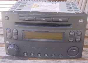

so basically i have to replace this (except the bose one since thats the one i have)
Old Aug 11, 2008 | 08:53 PM
blasian's Avatar
blasian
iTrader: (29)
Posts: 33,731
From: Get out my way pimpin, LA
That is correct. Just another little bit of advice... the 03's face is a different color but you can swap the faceplates. I got an 04 and swapped the face from my 03 and it worked fine
