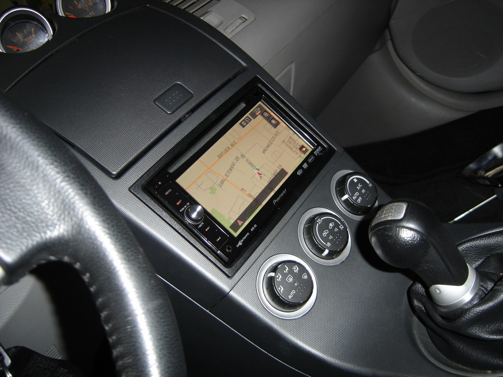

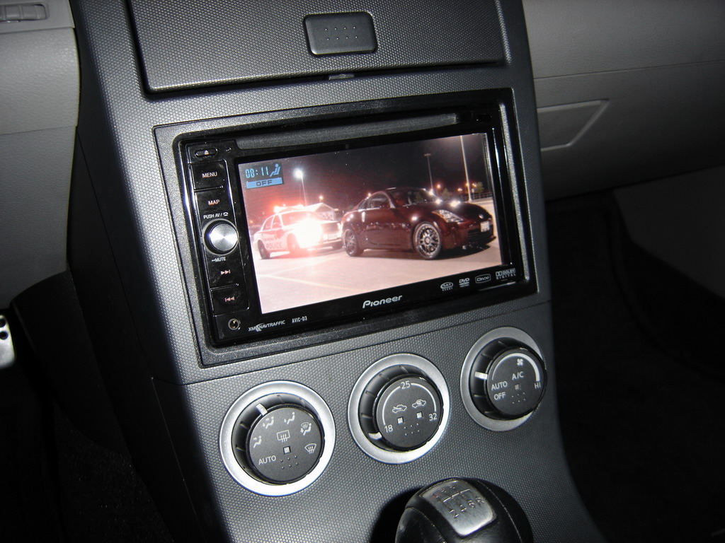

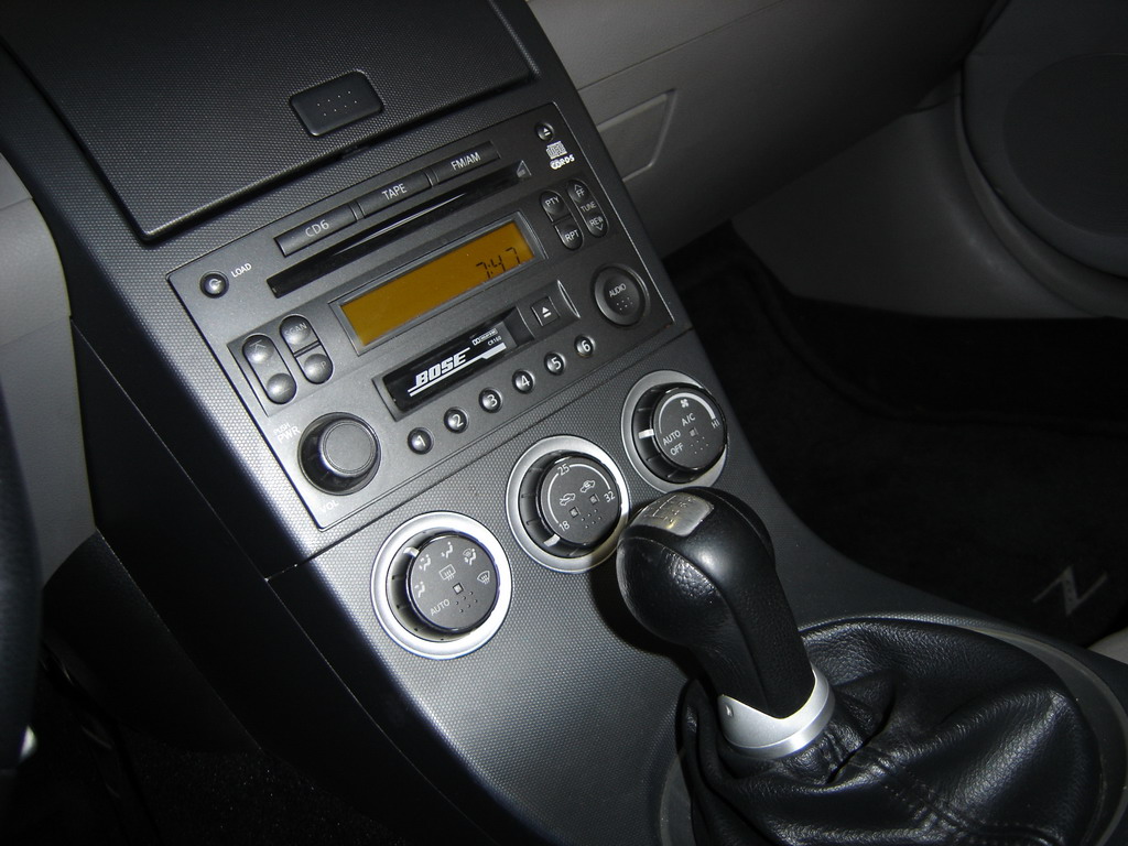

So I bought a Pioneer Avic D3 for my 03 350z with Bose. There seems to be no real thread related to putting a D3 into a Bose equipped car. This thread has some info: https://my350z.com/forum/audio-video...all-guide.html but the wiring is for a non Bose car until page 8 with some info.
I decided with everybody asking questions in that thread that I would make a thread related specifically to the Bose part of the install. Since taking apart the dash etc is covered in that thread I will not duplicate the information here.
I bought the following:
Avic D3 (obviously)
Metra 99-7704 Install Kit 03-05 350Z ONLY (99-7602 for 06+)
PAC ROEM-NIS2
The metra kit gives you the double din surround which you need to cut the center bar out of and smooth out with a dremel which is no big deal. The spacers are also needed to install the D3 into the stock brackets. The rest of the kit is garbage.
The difference between a BOSE and non bose equipped car is all in the wiring. There are two way to wire it up. There is a metra harness thats cheaper than the PAC ROEM-NIS2 but it doesn't allow to control of the line level to the BOSE amp. You basically take what you get and some have reported that their volume isn't very high or they had other weird noises.
I choose to buy the ROEM-NIS2 from PAC as I wanted to make sure I had lots of volume and wasn't annoyed by little noises some people have reported. The ROEM-NIS2 has exactly the same wire color as the D3 does so you just match them up. Really it's that simple. No need to splice the amp and antenna together or put grounds into screws above the stereo etc.. All the wires needed are in the harness including ground. Once you solder up the harness (see pic below) it's a plug and play install.
There were 4 left over wires on the PAC ROEM-NIS2 that are not used. It allows for low and high level inputs. Low level inputs are 25W and less and high level inputs are 25W and over. The D3 is 50W X 4 so obviously we use the high level inputs and just leave the low level ones.
I went the extra step and did the bypass so I can play DVD and program the NAV while in motion (easy to do) seen here: http://www.avic411.com/forum/viewtopic.php?t=4670
The only extra step was hooking up the Pink wire from the D3 to the VSS wire which is also covered in the other guide. Its the white wire in middle plug that goes into the AC box. It's just a splice into the wire deal and the D3 comes with extra pink wire and one of those handy dandy things to splice easily into wires. Everybody says it helps a lot with the D3 NAV accuracy.
Anyway if you are planning on a D3 into your BOSE 350z the ROEM-NIS2 makes it a snap. You do all the wiring on a bench and just plug it in and it works perfectly. Antenna is powered, amp is turned on, lots of volume etc.. Simple really.
Feel free to ask any questions.
Attached Thumbnails Avic D3 Install into 03 with BOSE (no nav)-dsc03138_resize.jpg   Avic D3 Install into 03 with BOSE (no nav)-dsc03139_resize.jpg   Avic D3 Install into 03 with BOSE (no nav)-dsc03140_resize.jpg   Avic D3 Install into 03 with BOSE (no nav)-dsc03145_resize.jpg   Avic D3 Install into 03 with BOSE (no nav)-dsc03146_resize.jpg

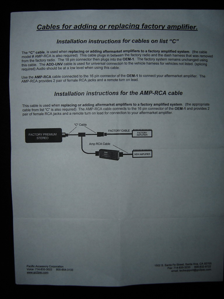

Originally Posted by j rad
would you buy the metra wiring kit if you had planned on running a aftermarket amp and sub off of the hu?
or still buy the PAC?
Absolutely the PAC will allow the BOSE system to run normally just as it does in our car now, its really just that simple. You could just unhook the BOSE sub and allow the rest of the system to run normally. (I believe that is possible)
Then use the RCA outs on the D3 to power an aftermarket sub amp setup. In reality you could leave the BOSE sub running as well off the deck normally and just turn the bass down on the D3 so it's not running very hard and filling in some midd bass, then use an RCA to run a 12 or 15" sub for some super big deep bass.
If you were planning on running an AMP for ALL speakers in the car and replacing everything then obviously you wouldn't need it.
Attached is the wiring and instruction for the PAC it should clear up some questions.
