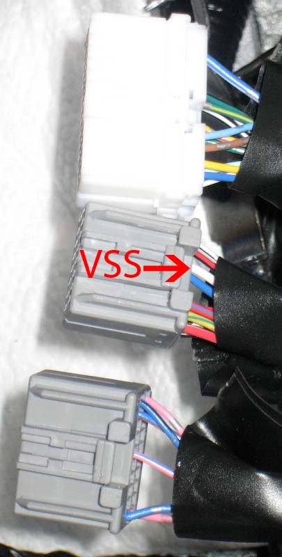

Does anyone know where to find the speed sensor for my 350z? Im trying to install a nav system.

its in the center console behind the a/c controls. Its a white box called the A/C amplifier. I think its the gray wire. Ill check on that.

Ok its either white or grey and its in the harness with the white connector. It is in position 20 which is in the bottom row if the release (key) is on the top. Depending on which way you look at it, it is either the the 5th or 8th wire from the first position.

Can you please verify the plug color and wire color again. I ran across another post on the AVIC411.com forum and someone is saying it's a grey connector. I've attached a picture here...
http://www.avic411.com/forum/viewtop...highlight=350z
