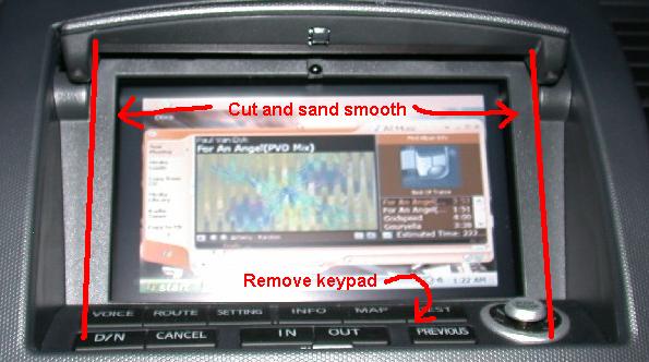

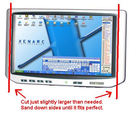

I had another question before I buy the Xenarc 700TSV. Every install that I have seen has taken the screen out of its original casing. There are buttons on that casing, and I was wondering what you guys did with them. Don't you need the buttons?
Yeah, I've installed my 700TSV and kept the buttons intact and usable.
I don't have good pics yet, but here is basically what I did:
By "cut", I mean use a plastic scoring/cutting tool.
You'll have to find your own way to permanently mount the screen to the inner center console.

ok...thanks...when you say remove keypad...do you still use the stock navi that came with your car? did you permanently remove the keypad? If you are still using the stock Navi, how did you connect it to the Xenarc?
I have so many questions...
I've removed it entirely.
I will fill that gap in with a hacked rubber pad that comes w/ the non-navi vehicles.
If you did want to keep the Nissan Navi then you would just need an RGBS to Composite video converter.
