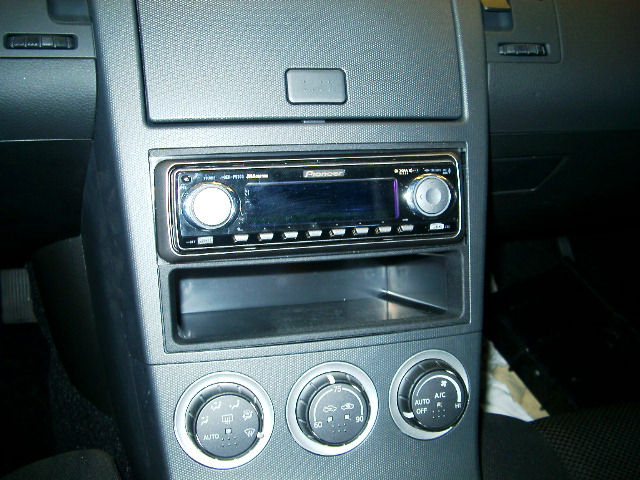

Here's my setup on my base model.

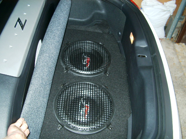

Here is my 12" HX2 subs in a custom fiberglass enclosure in my tire well.
Also here is the link of all my other equipment
