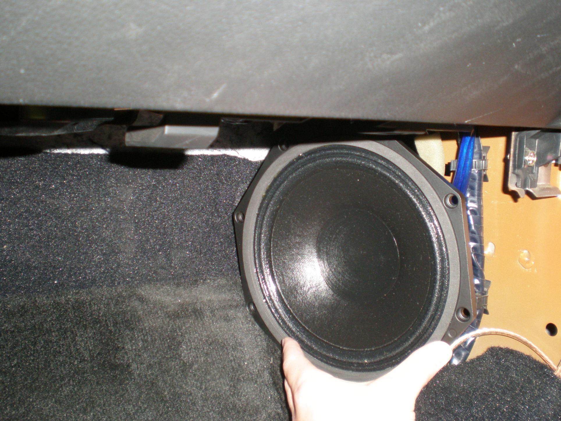

Has anyone ever moved the fuse box and BCM that's behind the driver's side kick panel? I'm ready to try it myself, but I'm wondering if anyone has already tried this and maybe has any advice? Maybe Bing (16psibrick)?
Here's why I'm asking the question:
I have 7" Peerless 830883 in the doors right now, tweeters up on the dash/a-pillar. I have purchased some B&C 8NDL51 drivers to replace the Peerless. The B&C have a big sensitivity advantage over most car audio drivers out there, and I think they'll provide me with the volume and impact that I'm interested in. Plus, they model well in small boxes.

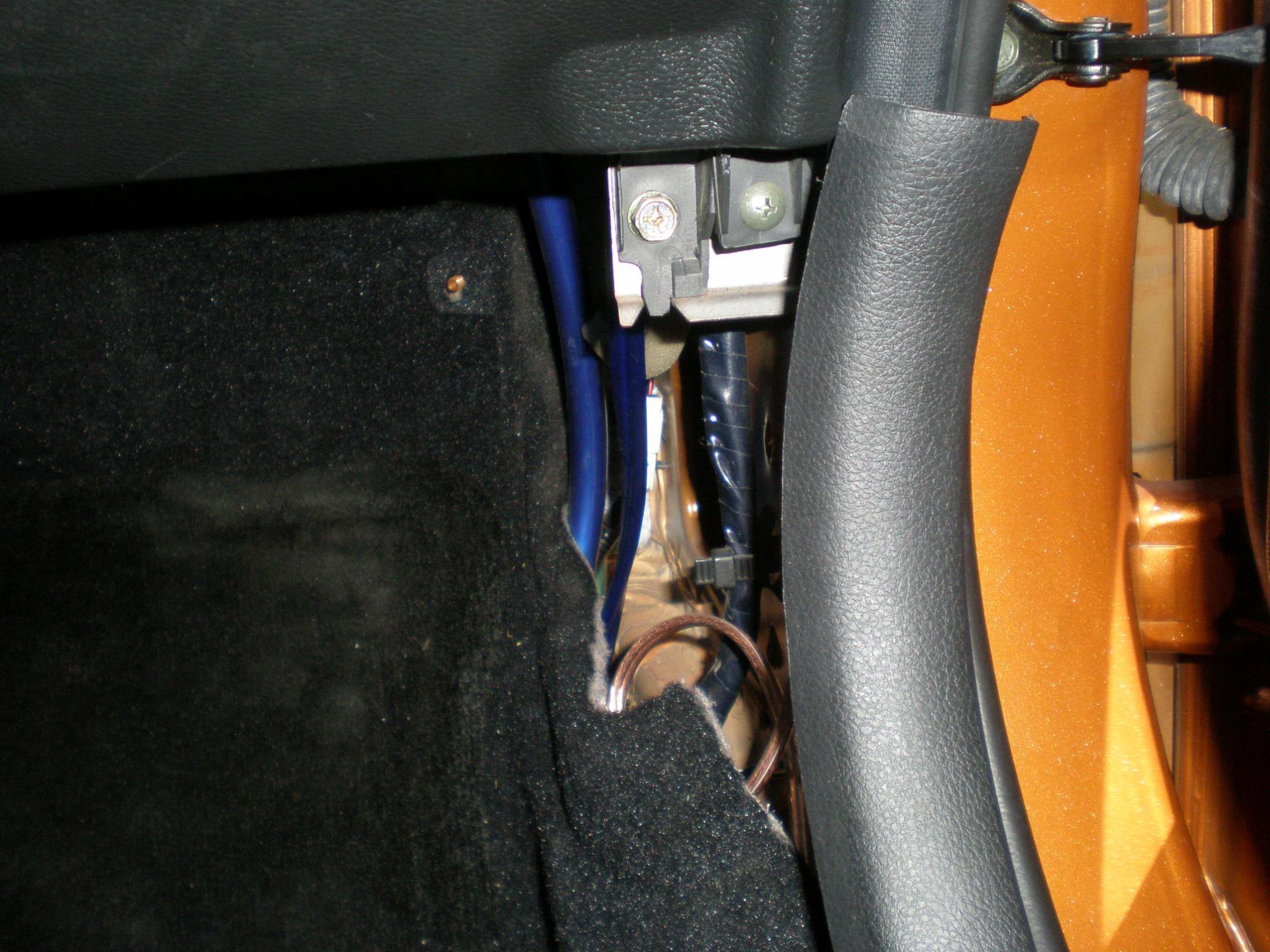

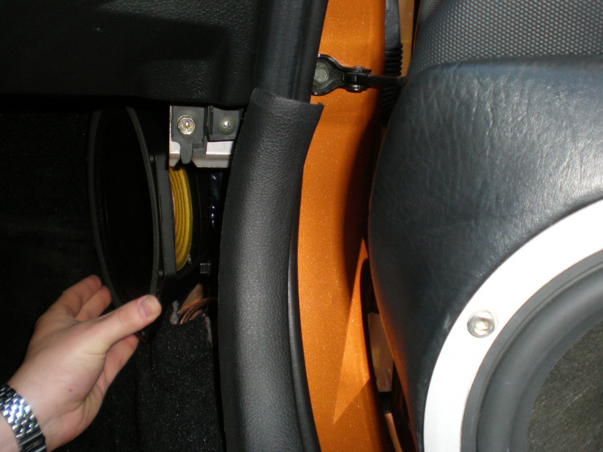

So... my thought is to put the 8NDLs in small fiberglassed sealed boxes in the kicks. Things look good on the passenger side; you can kinda stick them back into the fender.
Attached Thumbnails Relocate the fuse box and BCM?-p7020010.jpg   Relocate the fuse box and BCM?-p7020011.jpg   Relocate the fuse box and BCM?-p7020013.jpg

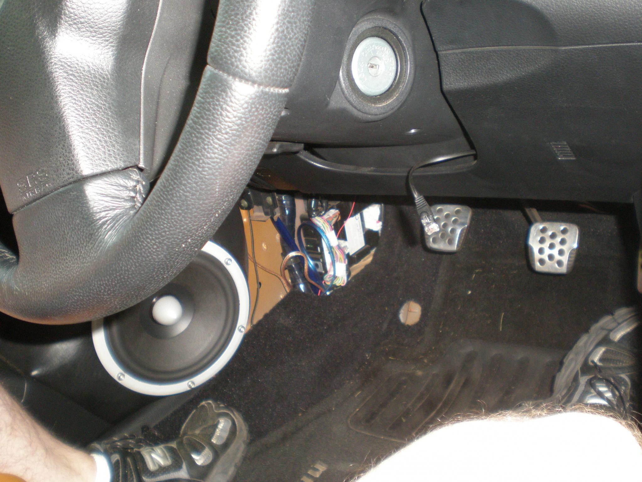

However, the driver's side is more complicated. As I'm sure many of you know, the fuse box (and the BCM) is behind the driver's side kick panel. If these things weren't in the way, it would be much easier.
Attached Thumbnails Relocate the fuse box and BCM?-p7020005.jpg   Relocate the fuse box and BCM?-p7020006.jpg   Relocate the fuse box and BCM?-p7020007.jpg   Relocate the fuse box and BCM?-p7020008.jpg   Relocate the fuse box and BCM?-p7020009.jpg

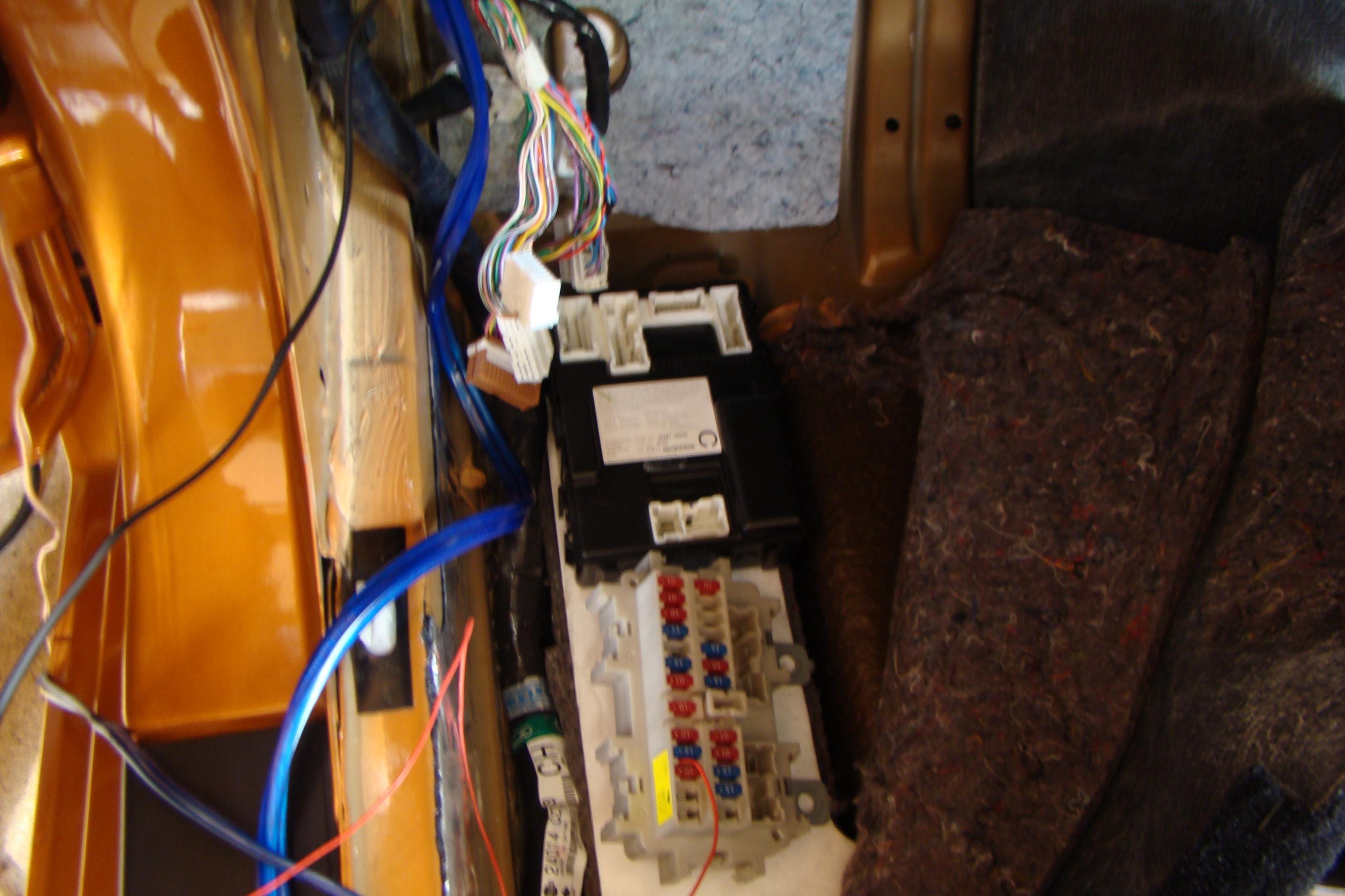

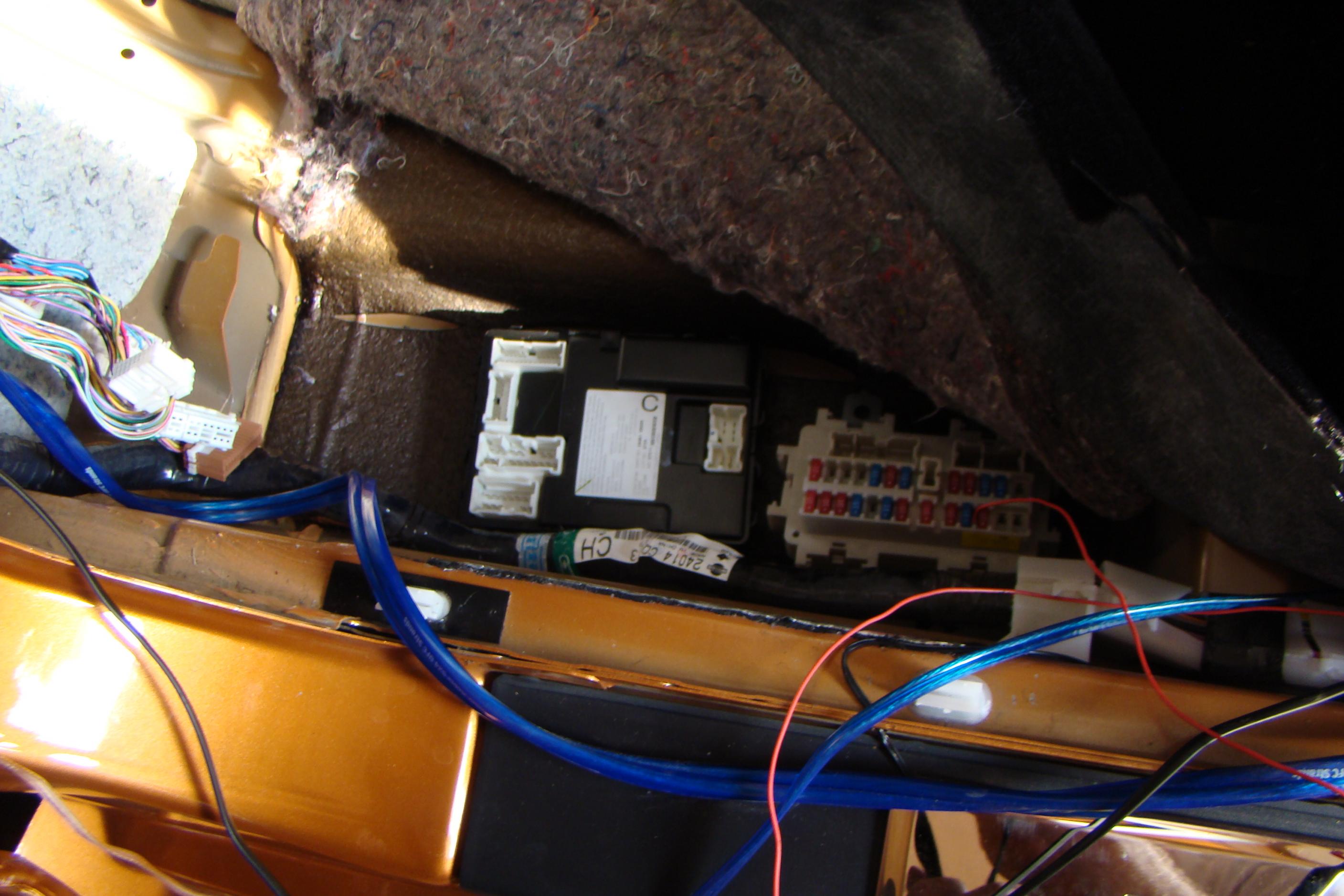

Thanks for the input from everyone, both for and against. I went ahead and did it (back in July; I'm just getting around to posting it now). The car has been running perfect since doing it, no problems. Here's how I went about it:
Under the floor mat, there's a cavity that's filled with styrofoam. I figured this would be a perfect place to relocate the fuse box. As you can see everything appears to fit tine.
Attached Thumbnails Relocate the fuse box and BCM?-dsc02573.jpg   Relocate the fuse box and BCM?-dsc02576.jpg   Relocate the fuse box and BCM?-dsc02577.jpg   Relocate the fuse box and BCM?-dsc02579.jpg

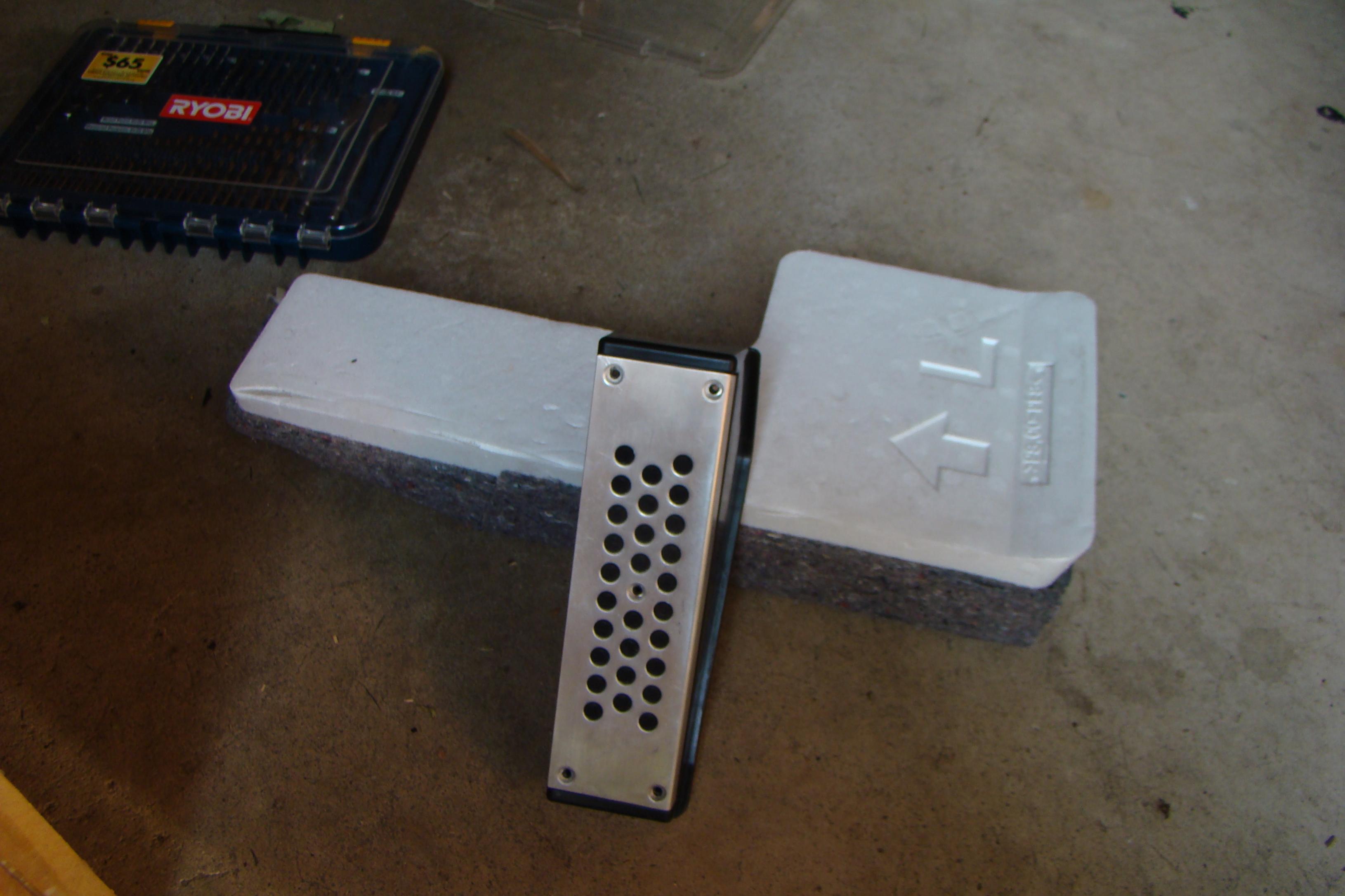

For your reference, here's the styrofoam piece out of the car, with the dead-pedal as size reference. After putting the BCM and fuse box in this cavity, there's still room for other things, if you wanted...
Attached Thumbnails Relocate the fuse box and BCM?-dsc02580.jpg   Relocate the fuse box and BCM?-dsc02581.jpg

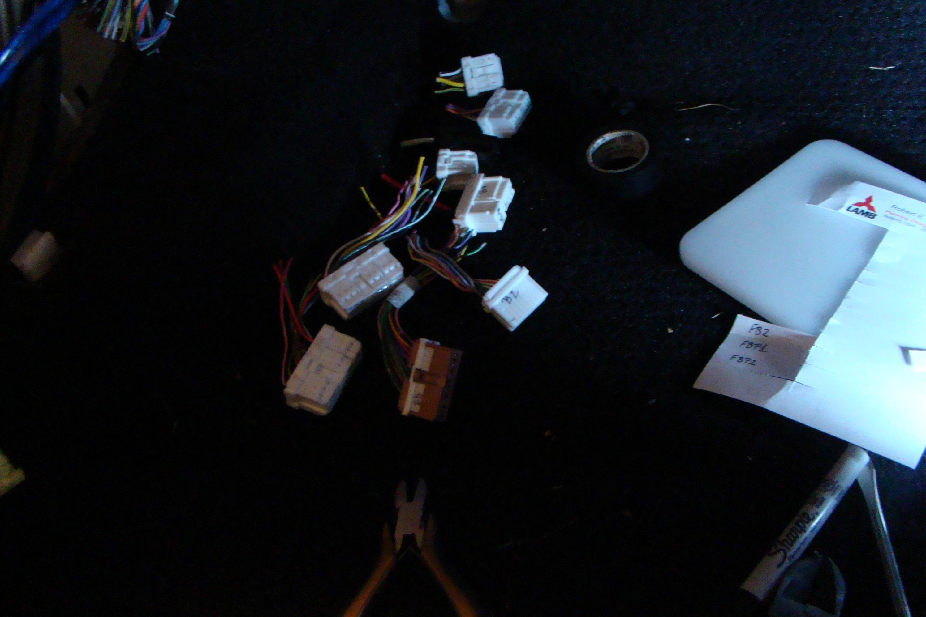

Time to start cutting.
(I would highly suggest labeling each wiring bundle before continuing. You can see some of my labels here. One thing I didn't anticipate: two wires with the exact same color & stripe, on the same harness. Please watch out for this and label appropriately. Once I re-wired everything, it didn't seem to matter which way I wired it, so maybe it doesn't matter...)
Oh. My. God. What have I done?
No turning back now.
Attached Thumbnails Relocate the fuse box and BCM?-dsc02585.jpg   Relocate the fuse box and BCM?-dsc02586.jpg   Relocate the fuse box and BCM?-dsc02587.jpg

Here's a couple of shots of the extensions, during soldering. I shrink-wrapped each solder joint. Unfortunately, I only have shots of the soldering I did at my workbench. For every solder joint at my workbench, I had to make a corresponding solder joint in-place, while contorted sideways in the footwell.
