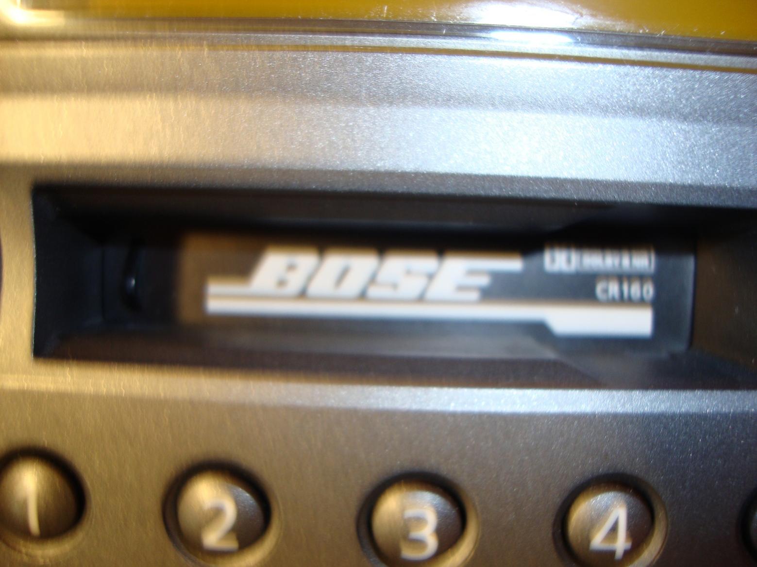

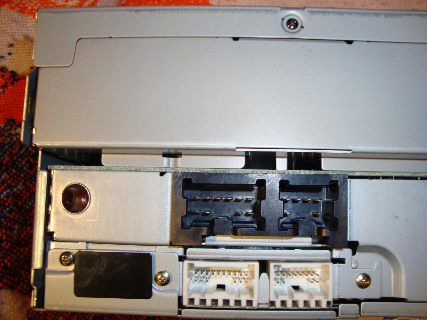

For everyone wondering if the Bose 6cd changer will work with a base model 350z with no bose system it will. The wire harness will fit perfect there are two harnesses one longer than the other and both match perfect stock speakers work and have actually gotten a little louder. Only thing is since the base model z has no stock subwoofer this will not work besides that everything works tweeters front and rear speakers. I dont really see any improvement other than the fact you now has a 6cd changer and tape player. The bose stereo was taken out of an 03 touring Z and the non bose stereo was from a 03 base Z. Im not sure about the other years but i would think this would at least work from years 03 -05 base and touring Z's. One more thing if anyone is doing this to get the bose brakets to fit you have to loosen the white box that controls the ac/heater and move it forward just enough so you can push the brakets into place.

I forgot the two black connectors on top are the ones that i used for the non bose z. I think the bottoms are for navi and dvd i dont know
