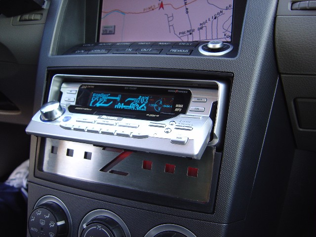

do alot of of searching here, and you will find a few people that upgraded speakers, subwoofer, amps, etc, and kept the stock Bose head unit. Just be careful--it uses non-standard (differential) ouputs, and you need special line convertors to take the diff output to line level output for input to your amplifiers. I think Soundgate makes some nice convertors and a few people here have used them with good success.
I tried a couple different convertors on my setup, before I threw in the towel and ditched my Bose Head unit altogether. I was disappointed with the overall sound of the head unit, after alot of upgrades, and it may have been related to the convertors.
I finally decided on the Pioneer Premier DEH-840mp head unit, and I love it !
Here is a recent pic:
Attached Thumbnails do I NEED to change out my Bose HU?-open_combination.jpg
