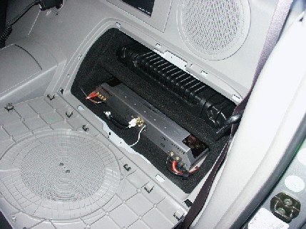

Default No heat problems here:
in the stock sub location with custom rack:

My guess is they had the amp at too low of an impedence, so it was running REALLY hot. Often, best buy sells the wrong amp for a given sub, and then it will run really hot. I bet that the other Z has problems with the amp shutting off too. Under the seat SHOULD be ok, but then again there are SO many other places it could go that would never be an issue (like in the factory sub location). Nice amp btw.
