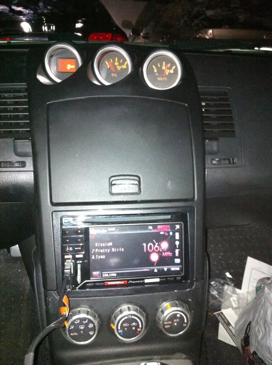

i went to the local car toys and purchased the kit for 22 bucks and then maneuver it with the stock frame to let it fit and then from there on the installation back into the car was just maneuvering the whole thing around to where it'll sit flushed. =) Good luck.
btw. I used an older model pioneer, the avhp3300bt but it should be the same thing.
