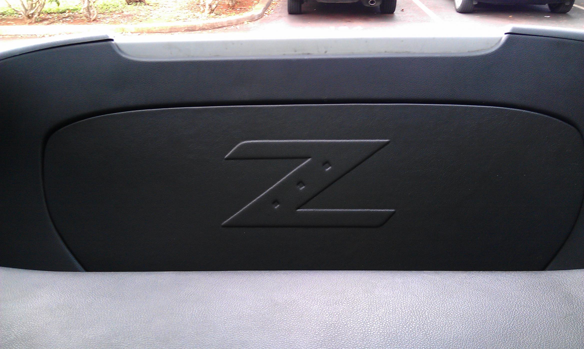

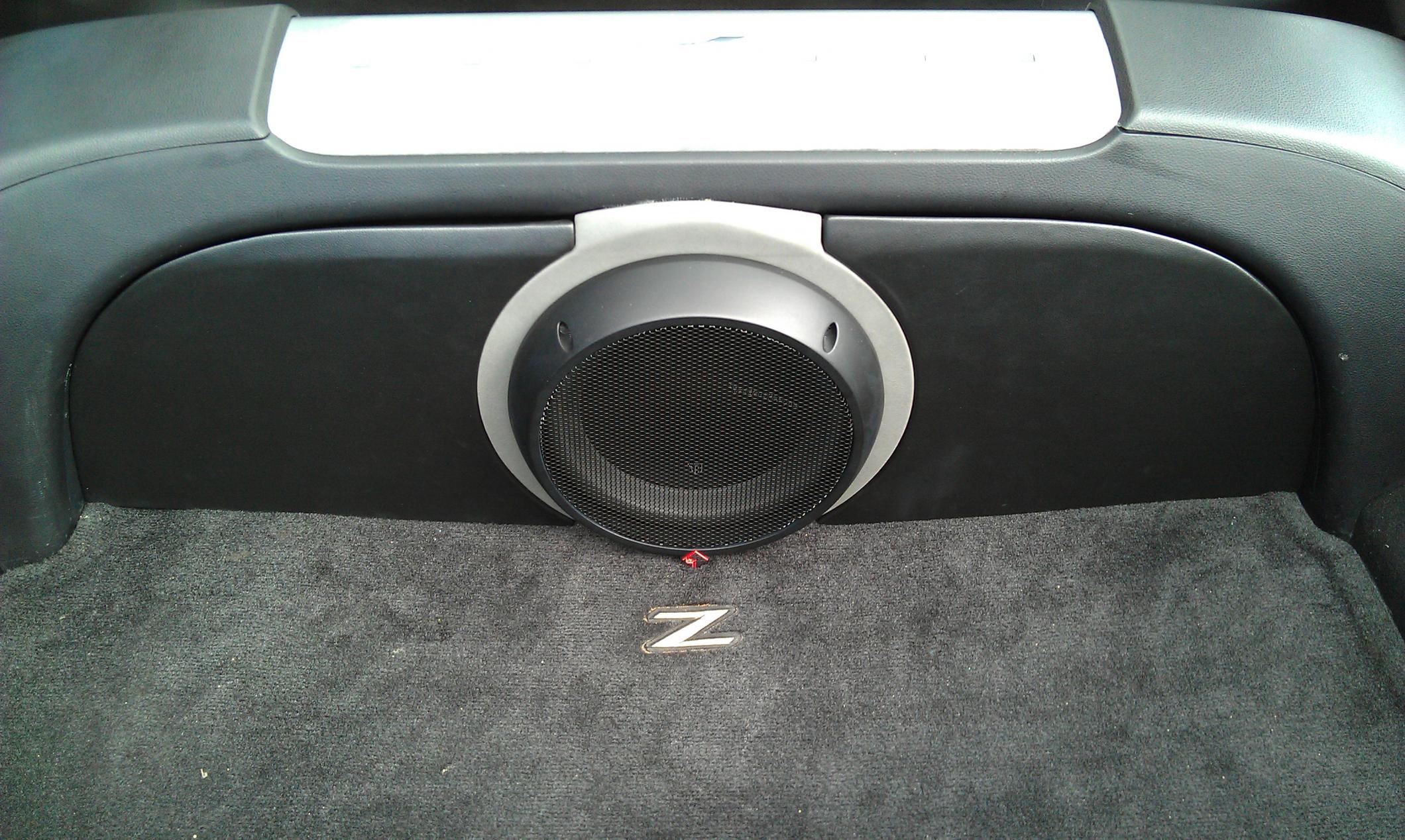

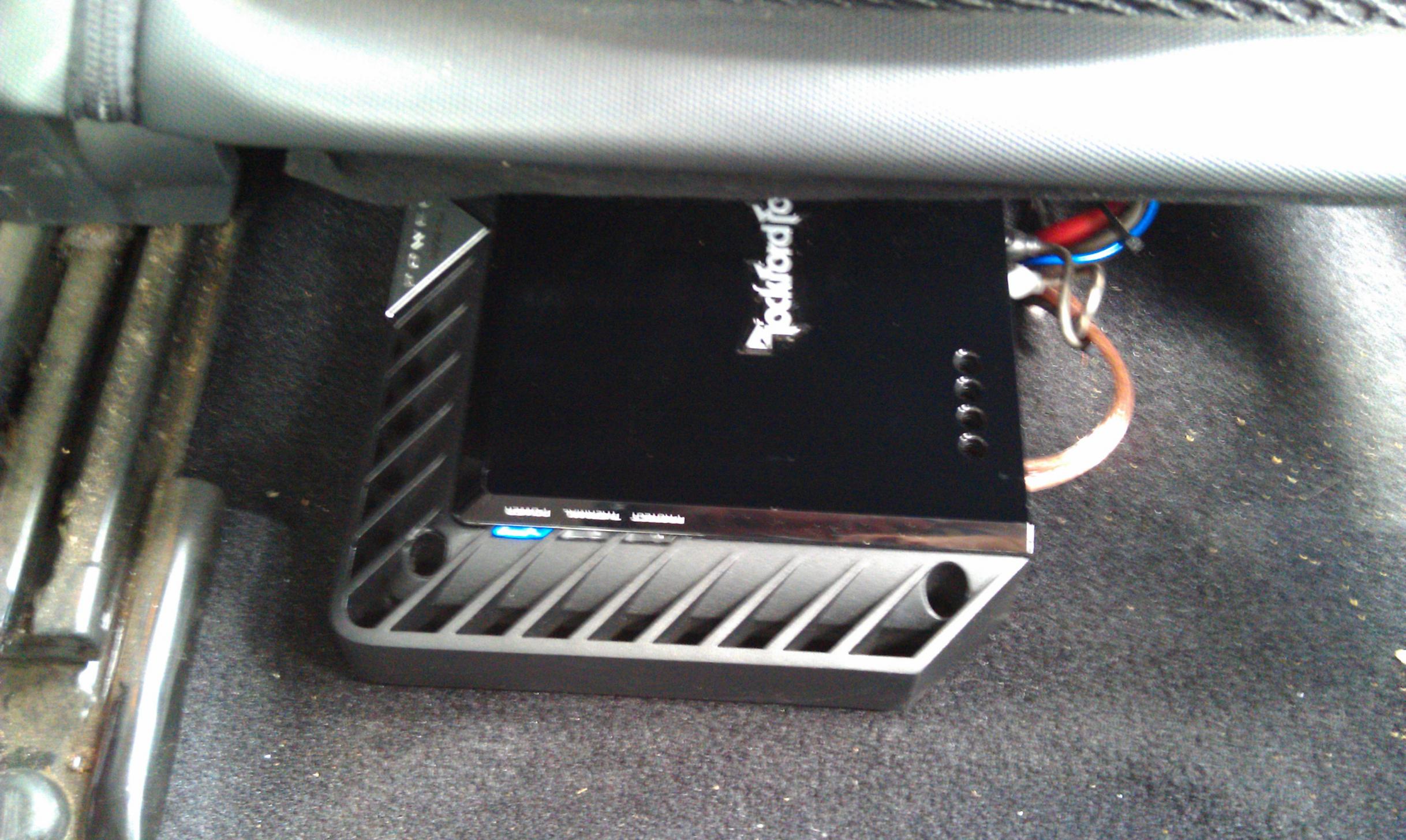

Ok, as promised, I took pics. Sorry if the quality sucks, used my cell.
Again, I have a Rockford Fosgate T1 10" in a custom box, with Rockford Fosgate T500-1 amp, and Pioneer AVH-P3300BT head unit.
The box is wrapped in vinyl. Tried to match the texture and color of the interior plastic. The gray ring around the sub, was an attempt at matching the color of the car, since the vinyl shop was out of stock on the color that matches the stabilizer bar.
The amp is bolted to the floor under my passenger seat. what you see is the best shot I could take, without unbolting and removing the seat.
Attached Thumbnails Finally going to add a sub.. suggestions?-imag0012.jpg   Finally going to add a sub.. suggestions?-imag0014.jpg   Finally going to add a sub.. suggestions?-imag0016.jpg   Finally going to add a sub.. suggestions?-imag0017.jpg
