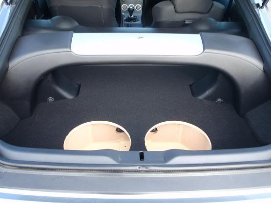

i decided on this enclusre after my ideas of weight shaving got me into a falt 13 and the SRQ cubby box.. no bueno. at .66 ft, the box is too small, very unlinear sound, and the plastic dances in the car w that sub.
I located THIS on ebay and had it custom built for a 13, center, and reduced the airspace perfectly to .88 ft cu. It fires up, is the farthest back, and the lowest CG of any sub option.
The box itself is EXTREMELY well built and can be cut for 2 12s or 2 10s, or a single 13 etc. Its a full flase floor, and weighs about 30bs.. sounds heavy, but its pretty light. removes easily as well. This with the flat sub reduced my weight quite a bit.
The box i ran before was 2 10w7s and was also high CG ( center of gravoty) made the car drive like hell.

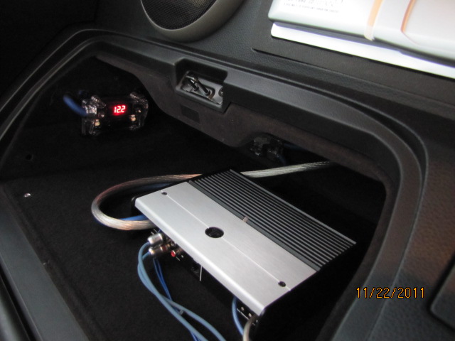

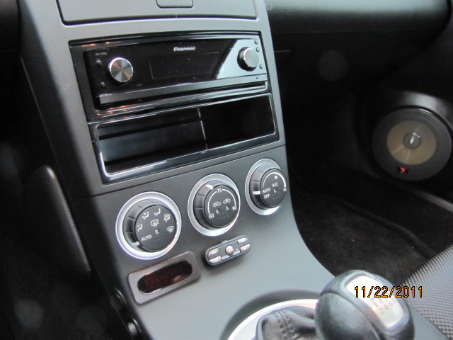

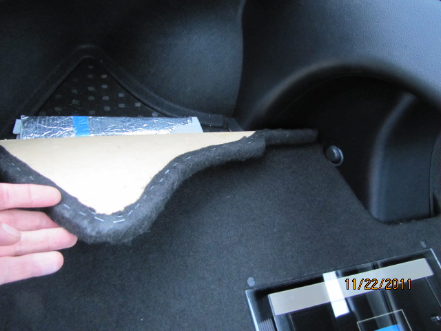

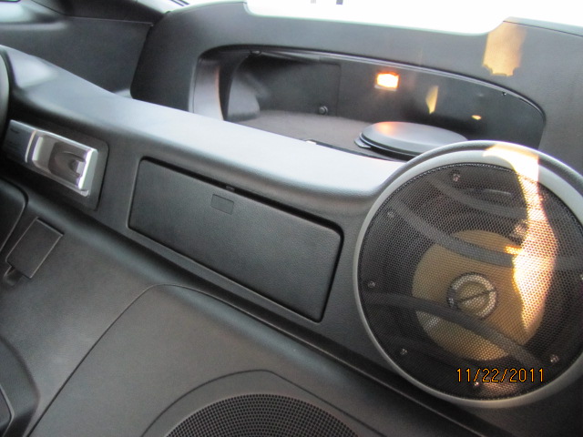

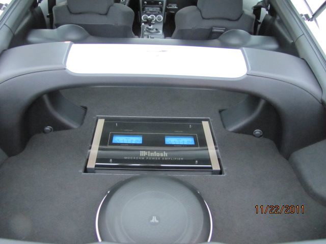

hello i built a false floor to replace stock one. i used the JL 13-tw5 it sounds great. i picked the flat JL 13 over others because it fit my box air volume the best. i looked at all the others and in my opinion the woofer needs to match the volume of your box. the tw5 is designed so you can have a large subwoofer in a small box, but it kicks butt. go to the JL audio website it has all the info you need to pick the right sub for your box. it would be a mistake to stuff two 10" woofers into a box that is too small. the sub floor is the same design that you can get on ebay, all the corners fold in so you can get it into the car. the other good stuff is a pioneer DEX-P99RS headunit, focal speakers front and back. i put in door pods in and custom mounted the tweeter. also thats a mcintosh 4 channel amp and i have a JL XD600 for the sub. the sub amp is tucked in the storage box behind passenger seat. the pioneer is their flagship model, copper chassis, L & R 31 band equalizer, highend 24 bit dac, auto time alignment and EQ. the auto alignment and EQ was worth the price alone. also in the picture of the headunit below it is a radar unit and a seperate laser jammer. those are hardwired in for a nice clean unstall. forget to mention that i gutted the interior and installed sound deadiner in the whole car. sorry for the long post i didnt realize i did so much lol.

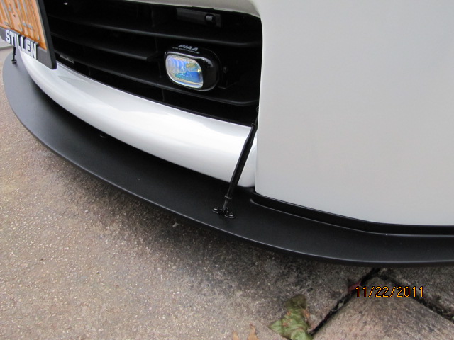

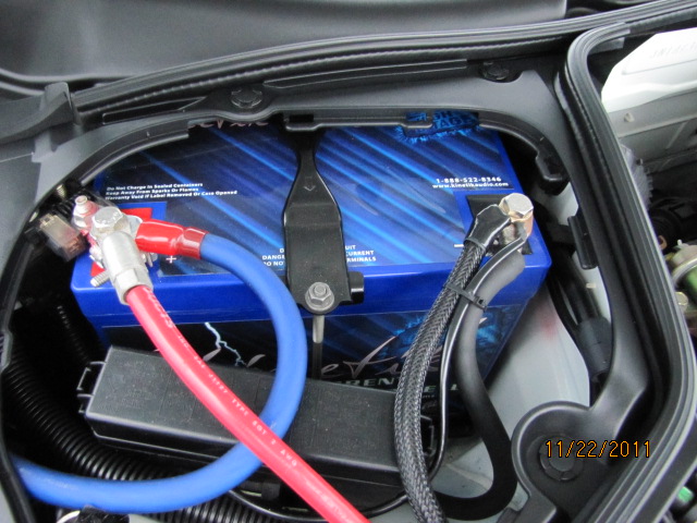

a couple more pics. pioneer cd changer, kinetik battery. the red 2 gauge goes right to the alternator the blue goes to the main fuse. i also have ground wires all over the place. and i just did the stillen lip/ splitter today, sweet.
