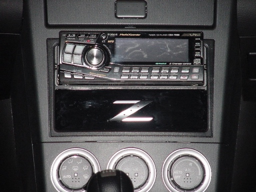

The other option (and my personal favorite) is to use the metal brackets and the dual din faceplate. Then you fill the opening with this ...
Hey 350ztrackz, where can I pick up that plate with the Z logo? I'm getting my Alpine 9807 installed Sunday with the Metra kit, and I'd LOVE to get it to look like yours.
Thanks

email me @ mgronholz@deloitte.com and I'll make you one.
