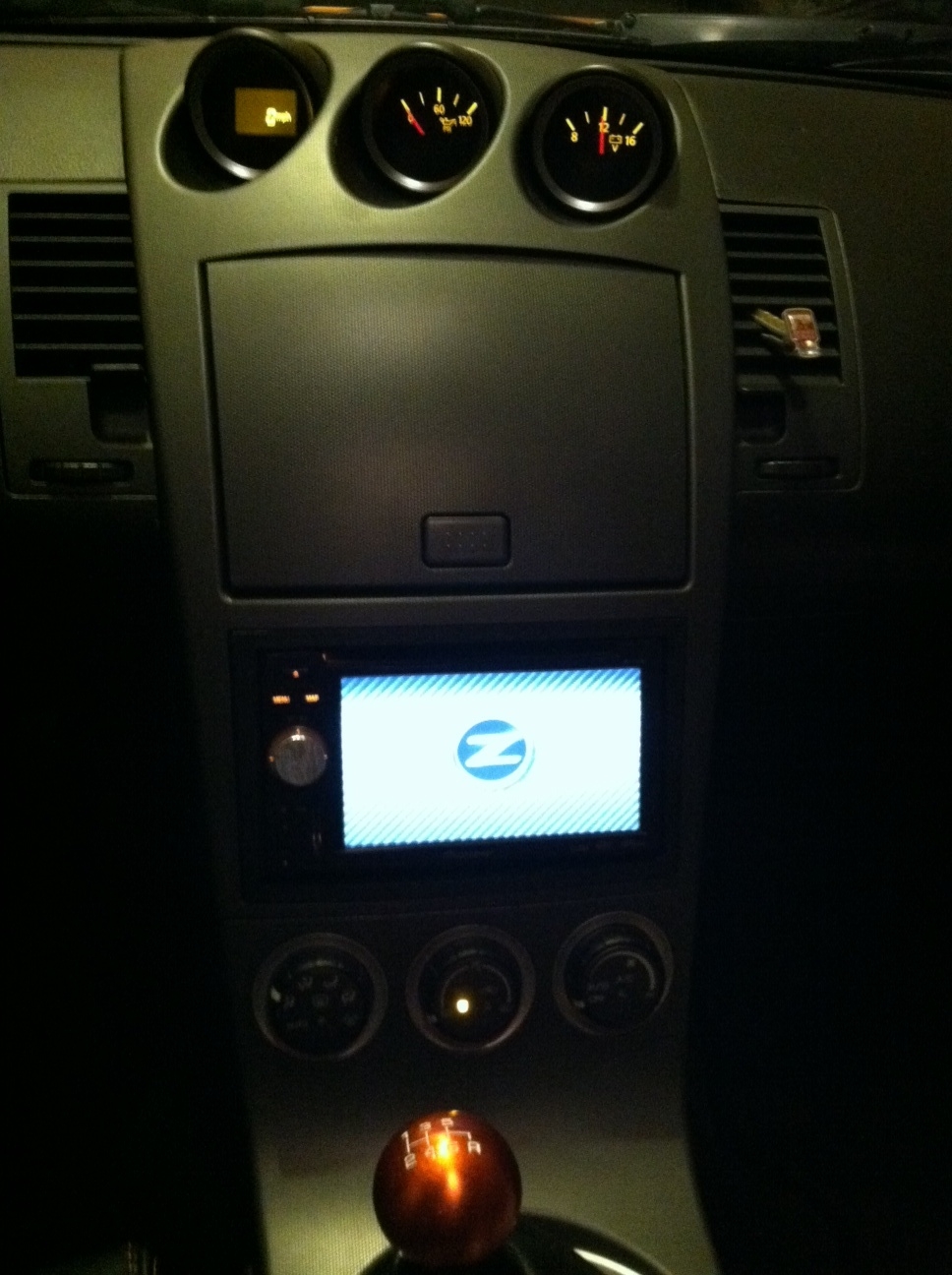

You do need a bezel for the front of the radio so you have no gaps. It is just a plastic bezel. You need a harness which you splice into the radio harness and then it just plugs into the original car radio plug.
I bought a Pioneer gps/radio/ipod/bluetooth/iphone/touch screen with the bezel and the harness all ready wired on this site used for $325 shipped. Sure its a few years old but its great. Took about 45 minutes to install. Plug and play baby.
