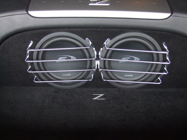

it should be a snug fit, you don't want it to slide out when warp speed engages,
no plastics covers were removed and there's really nothing to secure the box with.
